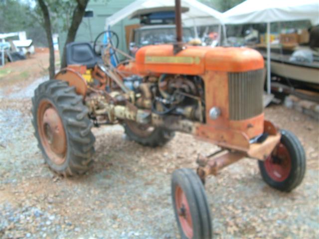

Have access? What does that mean? Are you looking to buy the tractor? If so, you need to check out the engine thoroughly before paying good money for something that may turn into a money pit. A few years ago I bought a 1951 Minneapolis Moline BF tractor (25 hp engine) for $1300. No compression on 3 cylinders, 30 psi on the 4th. Engine rebuild cost $800 parts/$800 labor. So check the compression on that Super 55. I'm still reassembling that BF.

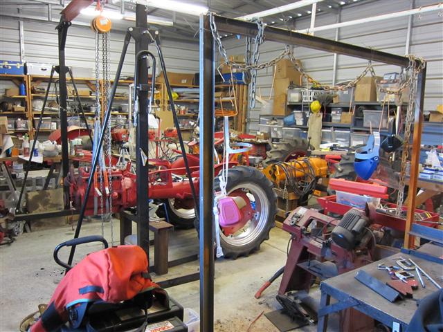

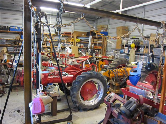

Tomorrow I pull the engine on my son's 1948 Farmall Cub--low compression even after regrinding the valves by hand. Needs piston rings, remachining on head and block, main bearings, valve guides, valves. I'll get the estimate later this week.

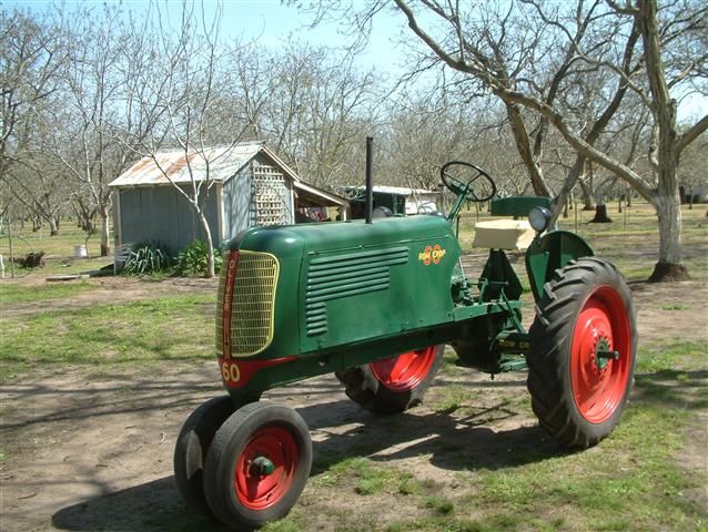

Here's my 1945 Oliver 60 Row Crop I bought last year for $2250. So far all it's needed is brake relining.
Do you have a garage/shop with concrete floor, engine hoist, gantry crane, floor jacks, jack stands, impact wrench, lotsa hand tools etc. All of these come in real handy when restoring old iron.

By the way flusher, beautiful oliver. I love the sheet metal on those old tractors. They have such a sleek look like it should be on a race track and not in the field. :thumbsup:
   / Antique tractor project #9
I drive it around the field just to keep it lubed--no real work. It's a hanger queen and a parade tractor. Need to replace the temp gauge--when I get time. This week's work is on the Farmall Cub--pull the engine and get it to the engine shop for a complete rebuild.
