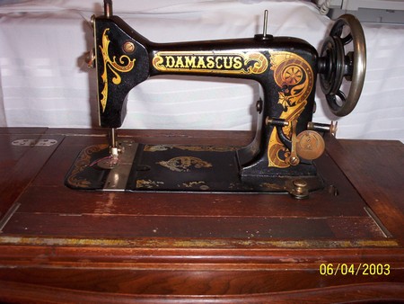

The CEO, whilst exercising her XMas gift certificate to her favorite auction house, picked up a "Damascus" sewing machine and cabinet.
I date this piece to about 1920, plus or minus 10 yrs. Its belt/treadly driven, and I GET TO FIX IT.
I'm going to disassemble it if it doesnt get to heady, lube it with 4 in 1 oil. But it needs a severe cleaning. Any thoughts on what to clean this with?
Anyone tackled on of these gizmos, a Singer perhaps? The attached pic I found searching the net depicts the actual machine we've got.
BTW, for those who collect or have auction addictions, the winning bid price was $40 USD plus 10% buyers premium. Even if it never ends up sewing a stitch, it is a nice looking thing that suits our home's aesthetic.

Thanks for the tips fellas. Here's an update. First, this machine wasn't just 'dirty', it was D-I-R-T-Y. At least 75 years of sumpin caked on it. I actually thought the finish was a black matte but after using some ammonia on an inconspicuous part, it became clear that this machine has a rich black enamel glossy finish to it. This presented another more troubling problem. The decals on it (CEO says to preserve them at all costs) are suseptical to ruin via certain chemicals, ammonia being one of em. /forums/images/graemlins/shocked.gif
Soap and water wont even dent the crud on the surface of this bad boy. Further research says some people actually use WD40 as a cleaner. Others said Turtle wax Bug and Tar remover works without ruining the decals.
This is gonna require several passes.
I dissassembled the lower end of this machine, used some goo-be-gone on the steel parts and that worked ok. WD40 and 3-1 oil unfroze it and have most of it turning now.

Pete ... I tried some Dawn liquid on this thing to begin with. After a minute or 2 I started to get a lil shine. Later, after letting some parts soak in solvent, I accidently dropped a drop, literally a drop, of ammonia on the part I had just done. Wiped it off and said "Chief, you're gonna need a bigger boat" kinda expletive. Basically, the Dawn just cleaned up the upper most layer of CRUD! This thing is DEEEEURTY.
I picked up some Turtle Wax Tar, Bug and Sap remover and this did get some of the scum off the decals without dispensing with em, but could not disolve whatever the heII is on the enamel.
Next challenge is to find a drive chord for it. I'm guessing the originals were rubber? Have to check with that place in Hebron Ohio that sells this kinda stuff. Name escapes me.
Lastly I got the treadle freed up and spinning like a top. The iron work is filthy also and I'm praying to god it isn't black enamel also. After about 20 hours on this puppy now, I can say this emphatically, AMMONIA has proved it's mettle, but it eats the decals for breakfast.
Perhaps I'm grossly underestimating the amount of cleaning passes this thing needs. 2 COMPLETE rolls of paper towels and I'm still at what appears to be square one, except for about 30% of where I did the ammonia thing (un-decaled sections). Anyway, it looks a LOT better than when I started ...
It's an interesting device, but not as interesting as our spinning wheels. That's another thread though.

After a lot of cleaning both the machine and the wood and iron .... just need some old bobbins and a treadle belt.
