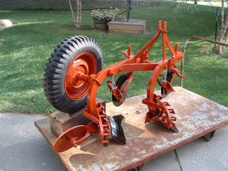

I am restoring a plow, like the one pictured. This is a Newgren slat plow built for the Willys Jeep. It used the Jeep's spare tire as the landside depth gauge. The spindle/hub needs to be a 5 lug on 5.5 pattern and I'm not quite sure of the axle stub length. That appears to be welded onto a plate that is held in position by 2 U bolts. Anyone know of a good source for the spindle/hub and stub axle? I'm finding lots of 5 lug on 4.5 pattern, but not much luck with 5 lug on 5.5 pattern.
Also any suggestions on the easiest way to reproduce the unit greatly appreciated.

Thanks! That is what I call service! Looks like what I need.
