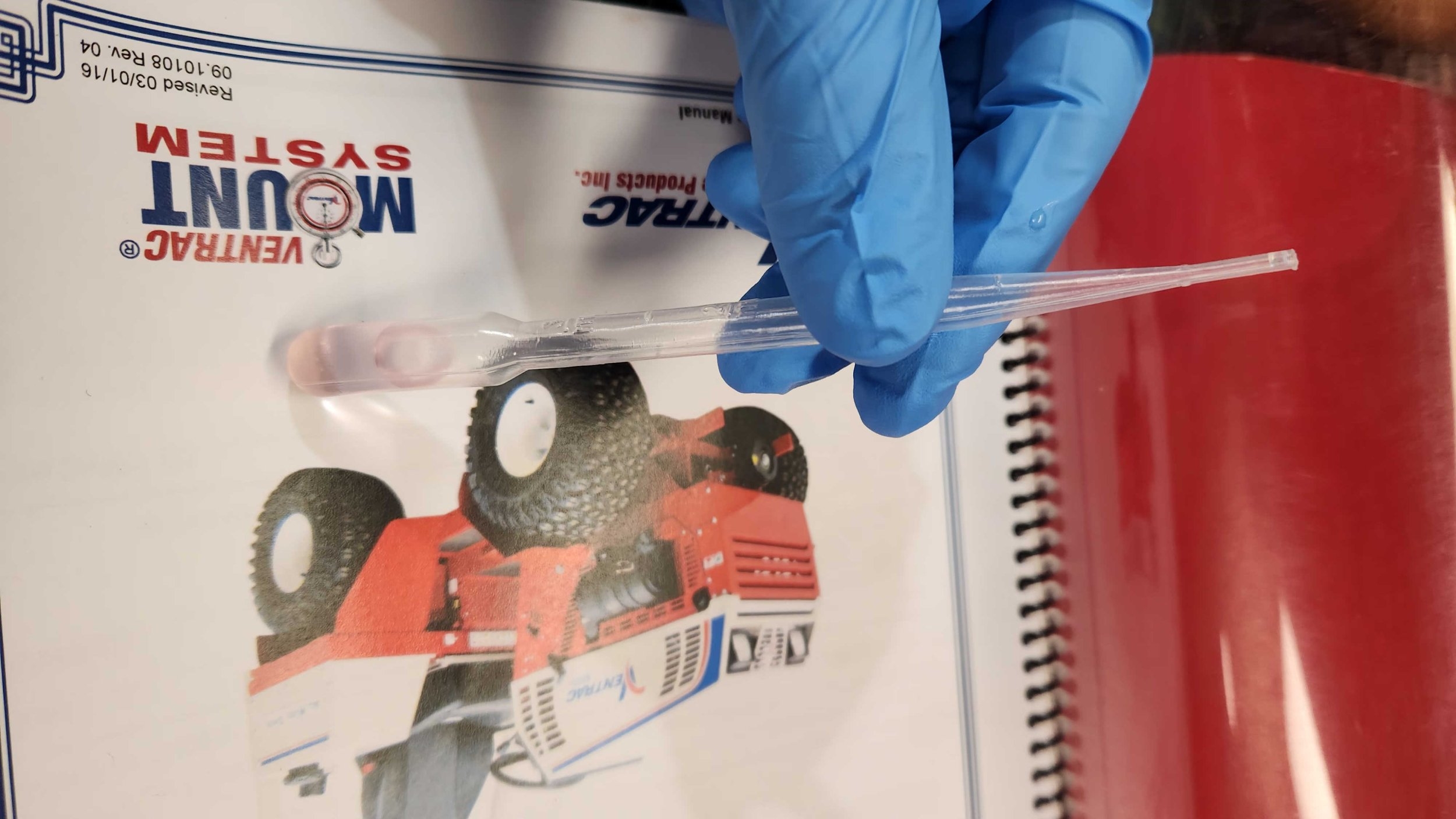

The time has come to change the antifreeze in my 4500P and I cannot determine which antifreeze to use.
According to the Ventrac manual on page 51 it states that 50% ethylene glycol is needed and "..ethylene glycol antifreeze of different colors can be mixed."
However, the FD851D engine manual on page 11 states a "Permanent Type of Antifreeze Green Colored" at a 50% mix concentration.
My confusion is the radiator has a clear antifreeze from the factory that has a slight pinkish hue to it. Looking into the radiator it does look more reddish. I'll attach a picture of the actual fluid in the radiator. It sort of looks like the Prestone pink premix, but not exactly.
Does this current antifreeze look familiar to anyone? Any recommendations?

I did quite a bit of research on this before doing the first coolant change on my 4500P. I paid attention to the note on page 51 of the Ventrac manual regarding using an antifreeze that was “low silicate, phosphate free”. Unfortunately, some of the manufacturers like Prestone don’t specify this, as far as I could find.
I asked Ventrac and their recommendation, which is probably what they use, is linked below:
I couldn’t source that in Canada so had to find another product that matched the specifications.

Fleet charge is the only Anti freeze I'd use in my diesel tractors. I used it for years and years without any issue. The idea is that they have anti shock additive that allows for full contact with the internal water jackets. That allows for better heat transfer when running hard. Very important in diesels really.
I always bought mine at Tractor Supply. They always carried it.
