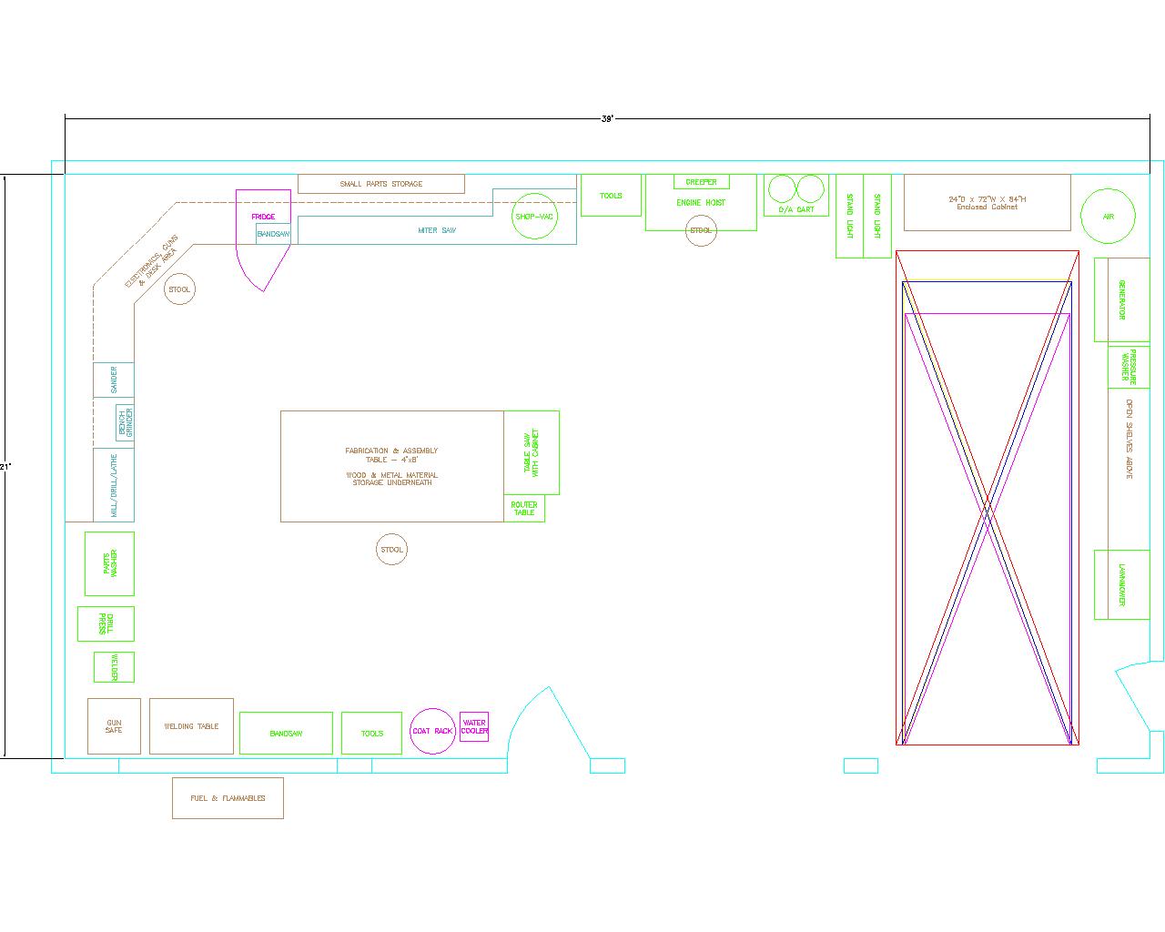

Attached is my current plan for converting my four car garage into a workshop for the farm. It will be service by a 200A electrical supply, fully insulated and drywalled. Two of the garage doors will be filled in, with the other two remaining for ocasional parking and pulling vehicles in for maintenance. THe ceilings are only 8'4", so I can't install a lift (unless someone knows of a shorty lift with limited height). I plan to do simple woodwork, metal fabrication (milling, welding, etc) as well as maintenance on all the farm equipment. Air will be hard piped throughout.
Any suggestions regarding the layout are fully appreciated. I don't currently own all of the equipment listed, but I will someday. /forums/images/graemlins/grin.gif
Thanks,
Dave

Interesting that you put your fuel and flamables right on the other side of the wall from the welding table.
Actually, I can't read most of the lettering for some reason, though if you have a printed version when I come out I'd be glad to give you my thoughts.
Cliff
   / Another workshop layout critique #5
Can't read the layout either printed or on the screen.
But, I offer an observaton on your uses. Don't include wood working equipment with any other machinery, cars or tractors. Sawdust gets into every thing. Woodworking equipment needs to be in its own enclosed area.

OK....let's see if I can get this to work.
Thake a look at this page using Internet Explorer. This should enable you to view a web format drawing that will allow you to zoom in to read the details. It may prompt you to install a small application, but it is free of any malware as far as I know (published by Autodesk).
v8dave, I have an entire list of requirements for the type of ideas you have suggested. Unfortunately, I do not have the available space to split the wood euipment into a seperate area. I will just have to do my best using the shopvac attached to the power tools. 4' high outlets, ceiling outlets and welder access near overhead door are all definitely going to be there. I don't currently own any neon signs, but it is an interesting idea, and I would not object to owning a couple. There will already be an airconditioner installed through the wall, a large room style unit. The compressor disconnect is an excellent idea, and the flourescent lights will definitely be electronic balast.

Dave,
I can't get the autodesk to work so I'll just make several general comments.
I've run metal working equipment along side woodworking equipment and that sawdust is a pain on greasy cast iron (and mucus membranes). Jerry rigging a shop vac is a pain and only partially effective. Plumbing the shop for serious vacuum may be a big improvement over a shop vac but I've never had the chance to try it.
If you get metalworking equipment, there's a pretty good chance you'll need a phase convertor since most industrial equipment is 3 phase. (Couldn't see the first link well enough to tell)
My shop was drywalled but when I added on to it, I used perforated steel siding instead, for sound deadening. If you're not aware of it, the pole barn steel suppliers make it for building liners. The perforations let the sound be absorbed by the insulation in the wall. You can really tell a difference between the old and new parts of the shop. (used it on the ceiling and walls) It comes in a selection of colors and cut to any length you want, in about 3 foot widths. Might even be cheaper than drywall if you include taping, finishing, and painting. Downside of it may be those perforations around sparks. Also, it cuts down on wireless reception if you do every surface.
No matter what you may want to change later, you got the most important thing right: its big!

Have you considered putting the bay doors in the middle, then putting metal working equipment on one side and woodworking on the other? You might be able to get some type of partition that would help keep the sawdust off the metal working equipment.
Also, get a real dust collector, a shop vac won't cut it for large volumes, not to mention the noise factor.
