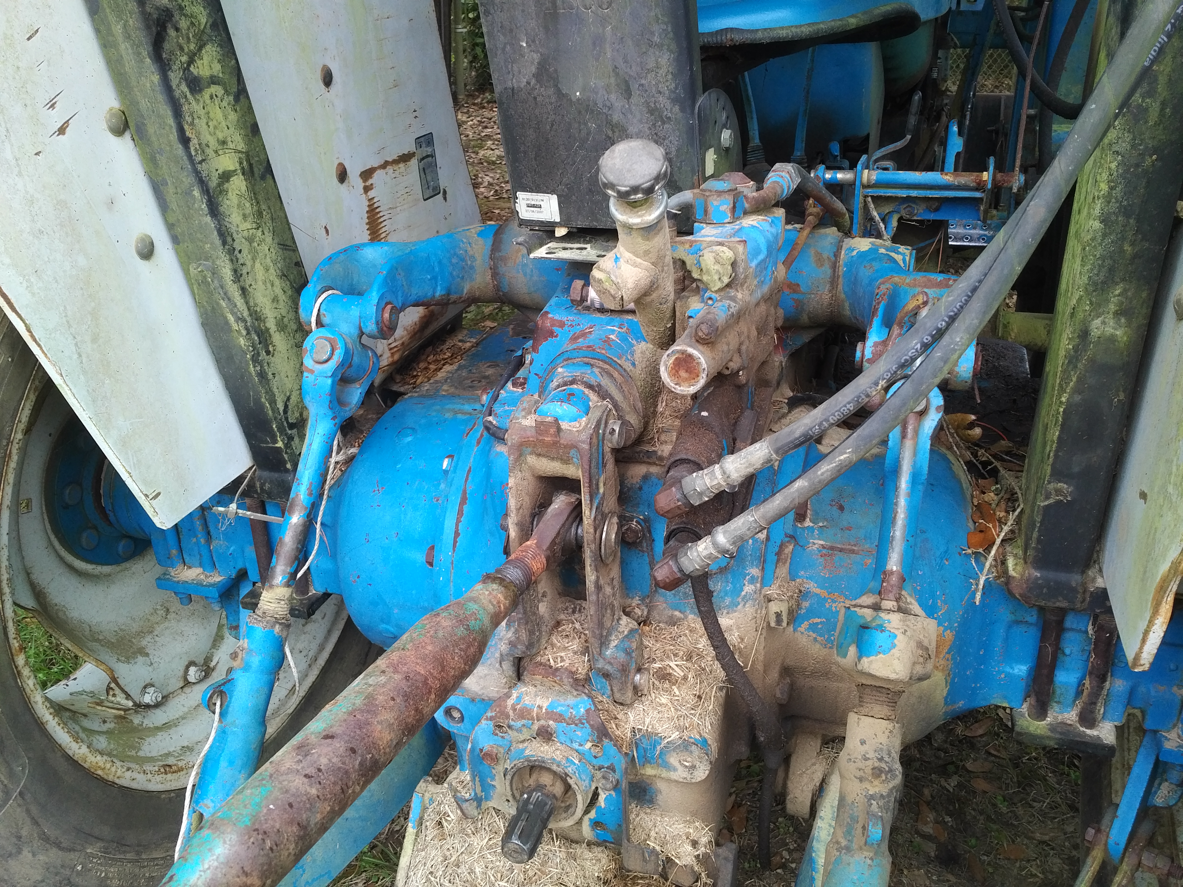

This is a 1987 vintage Ford 5900 that I inherited.
The rear remote has 2 hoses attached from the FEL. Right above where the hoses a plugged into the remote there is another cylinder shaped unit that appears that it might be for a remote that is plugged/deadheaded. 2-3 inches above it there is what looks like a switch.
Does anyone have a clue what the plugged cylinder shaped is??
Does anyone have a clue what the switch/selector would be for?? Is it indeed a switch??
(Note: The switch/selector I'm referring to is about 6" back toward the seat and just above the dead headed cylinder. I may have to clean it up and post another picture.)
Thanks for any info!!!!!!

Is that to switch between feeding the FEL or feeding the 3-point cylinder? On some machines, you can't have both at once.

Since I can operate both (FEL + 3-pt hitch) simultaneously ......... I would assume that is not it.

I think it a cap over a spring inside it. The spring being part of the hyd. valve that operates the remotes.
It looks like it’s opposite side from the linkage that operates it.
The switch looks like a flow control valve that controls how fast the remotes operate.
On other tractors, the top of the dial to the left is slowest position, right fastest.
/ Another - What is this thing??? #5
Switch is flow control. I have no idea what the cylinder shape thing is. Our 3910 has the same set up, but with dual remotes.

Thanks!! I think you are correct.
I cleaned the switch off after dark yesterday and failed to get a pic before I left this AM.
You can rotate the switch (control) about 15-20 degrees left and 15-20 degrees right. But where it is sitting in the pic is about midway.
It is associated with the hydraulic remote system ....... so..... the "flow control valve" is the only thing that makes sense to me.
