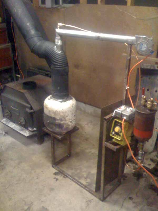

I really wasn't sure what kind of valve to get and ran across a metering pump on ebay, with a max output of 24 gallons per day, I figured it would be perfect. It has a high speed and a low speed. High speed is about 2 strokes per second and low is about 1, and the stroke is adjustable via a dial. I don't know if these things are meant for continuous use but I will find out. I already had a small squirrel cage type fan from my earlier experiments and used a regular ceiling fan control to regulate it.
Here is the pump and control setup. along with the oil tank(made from and old fire extinguisher that was going to be a water separator but I decided to use it as the main tank.
Here is the whole setup

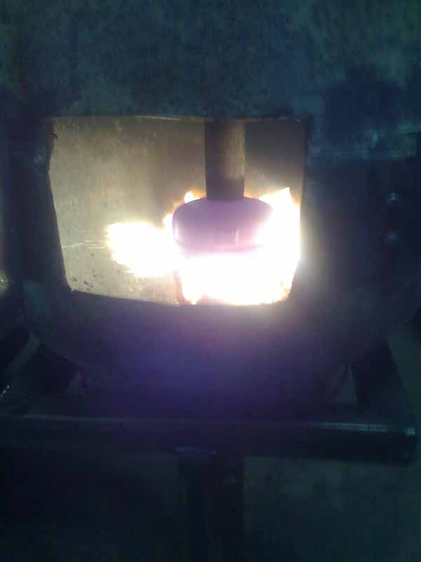

Here is a pic of it running.

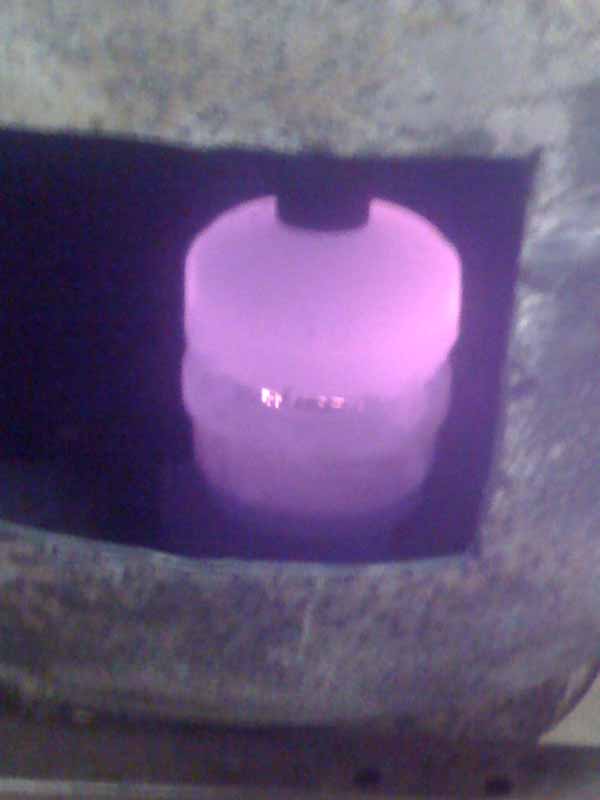

Here is one of it just after I turned off the oil.
It is made out of two cast 2 inch pipe caps. This make a very good heat chamber to get a good burn although it take a few minutes to get it up to temperature. As you can see it get red hot.
This is after about an hour of running.
It burned about half a gallon of waste oil in that hour.
I have much more experimenting to do but I don't think I can turn it down and still get a good, reliable, clean burn.
In operation with the door closed the flame extends to the sides of the tank and the sides of the propane tank will glow near the bottom. I am not sure I like that, seems like it might burn through relatively quickly like that.
I might try making a larger replaceable ring to go around it to keep the flame off the sides. This thing puts out as much heat the wood stove beside it.
