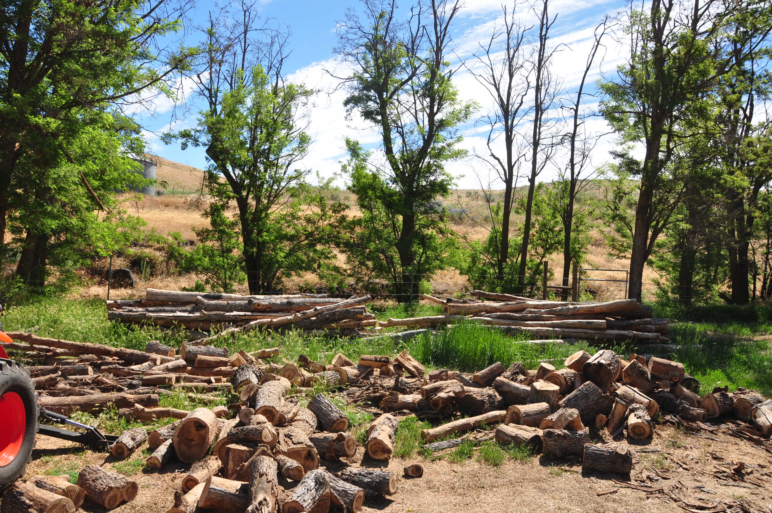

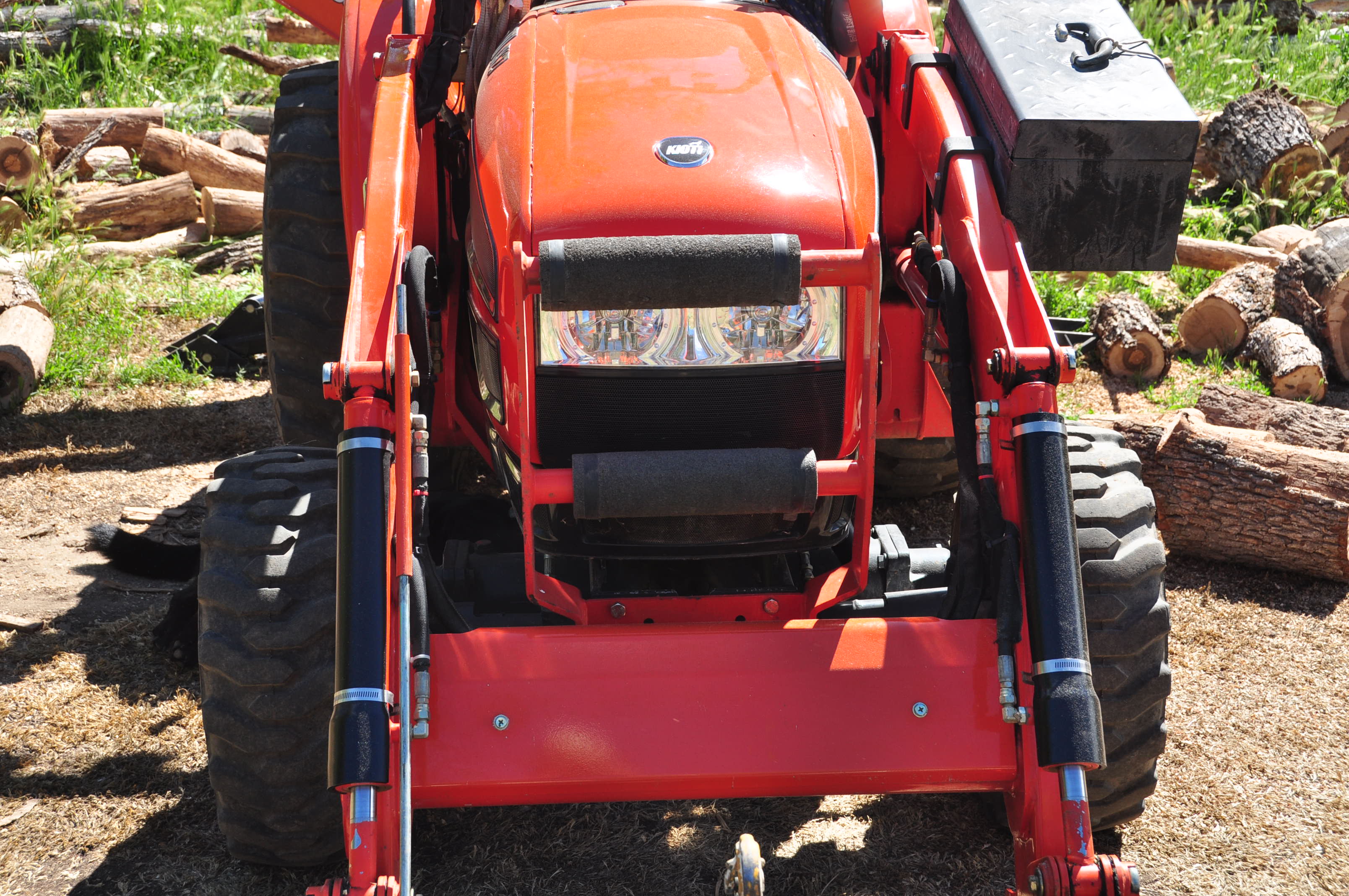

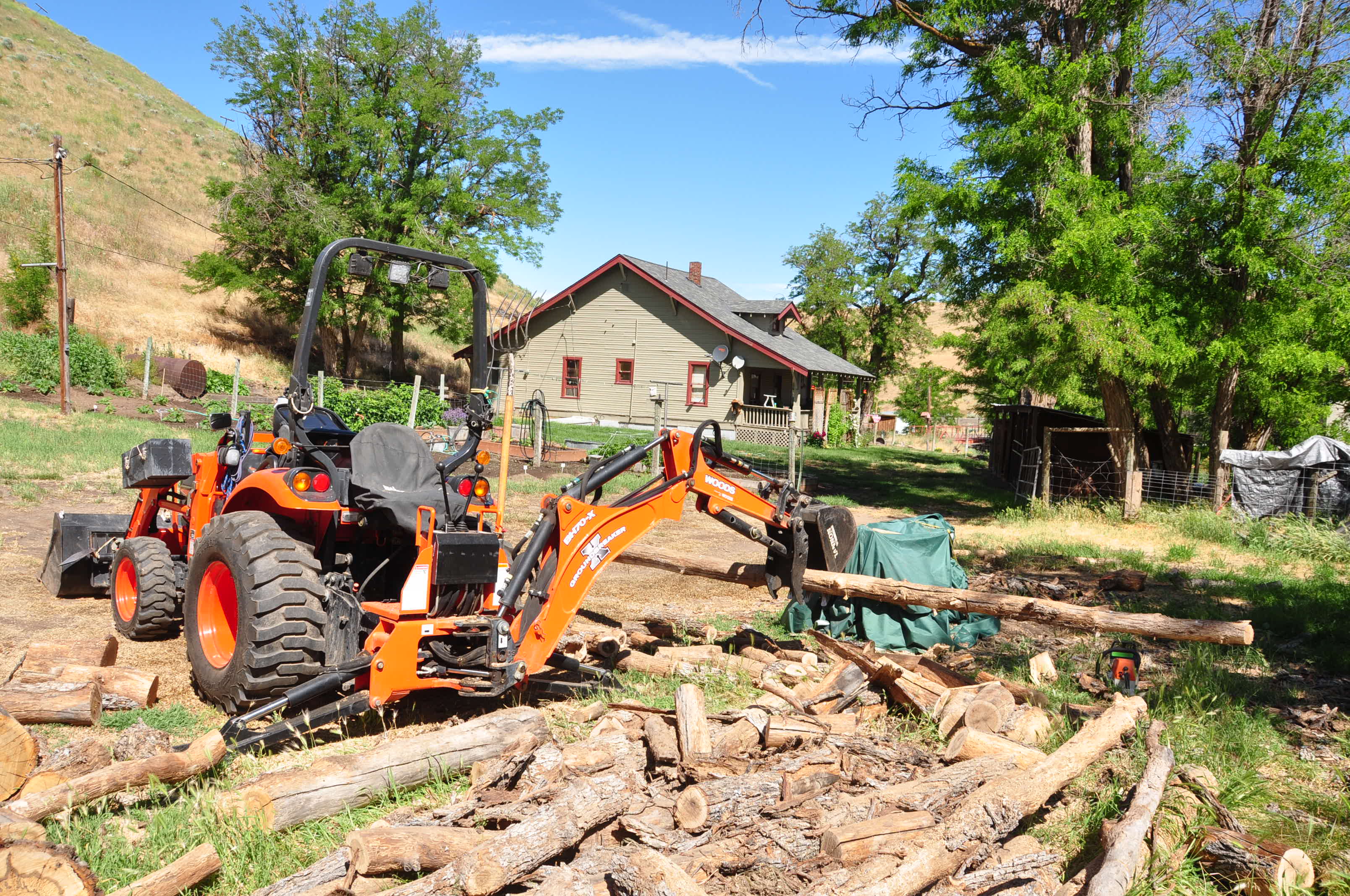

I use the hoe to hold logs for cutting. It saves me from having to bend over. I swing the logs that have to be split on one side and the smaller logs I cut on the other side. So it's all sorted when done cutting. I also made guards for the curl rams out of schedule 80 conduit PVC . Schedule 40 it too thin to be of any use IMO.

I do the exact same thing when processing firewood.
   / Another use for the Kioti
I'm hoping to get a grapple by next Spring. It'll make things easier and quicker even though I'll have to make two cuts on the log left in the grapple. The ability to move the tractor while carrying the log will speed things up as I can control where the stack is.

Ha ha my dogs eat our berries too. I use the BH sometimes too, the older I get the more I like this sort of thing. That's quite a hill by the house there!!
