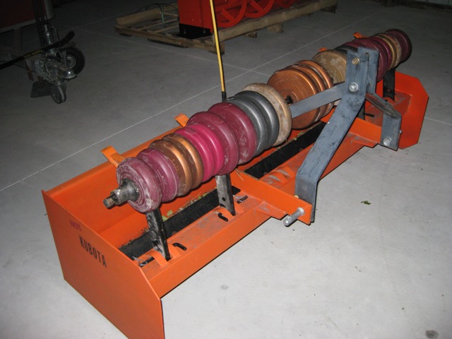

I keep finding more and more uses for these barbell sets I've picked up on the used market. This year, I am switching from a front blade and rear blower, to a rear blade and front blower. I have used this box blade before for snow and it works great for pulling the snow away from in front of the garage doors. However, this year with the front blower, I needed a little more weight on the 3 pt. Here's 178 lbs of additional weight. I simply flipped the scarifiers over and pointed them backwards. The bar rests between them and the A-frame of the 3 pt. hitch. Some heavy duty zip ties and I'm all set. Hopefully this will give me the additional weight to counter balance the new blower.

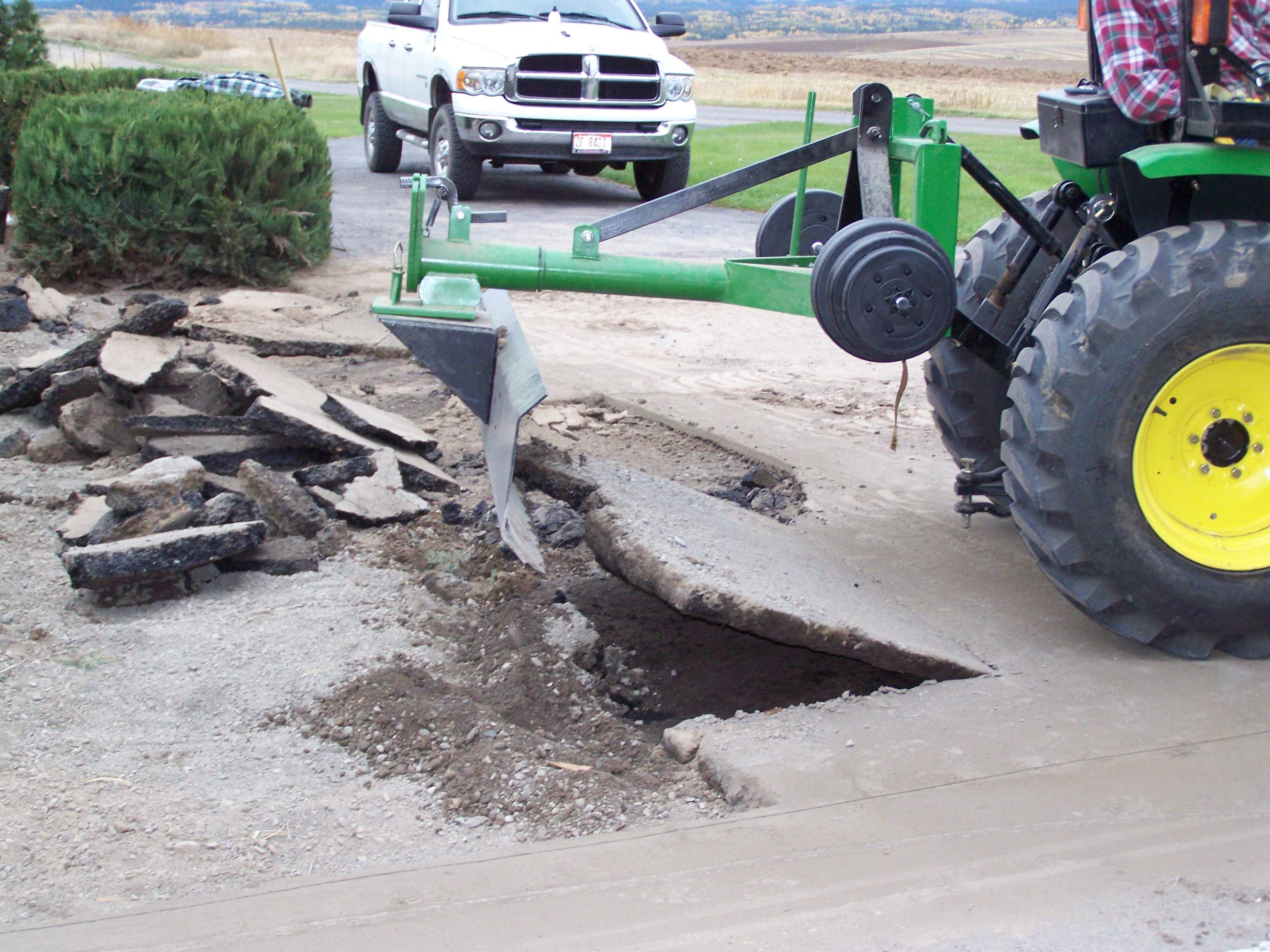

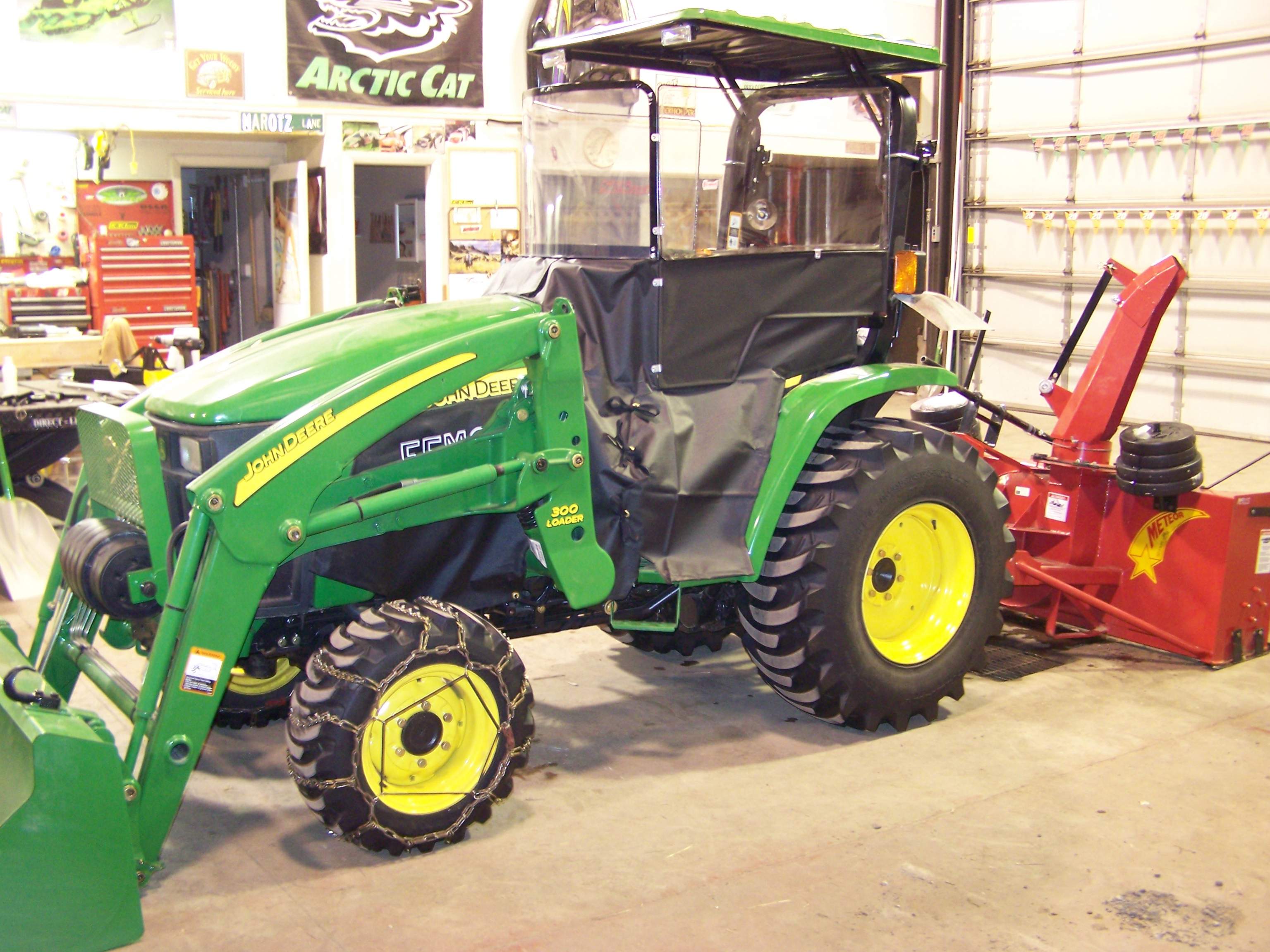

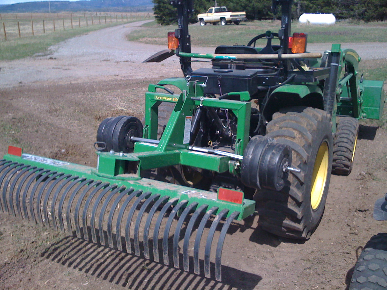

Yep, those weights are handy!!!! Rake, blade, snowblower, and front end weight....

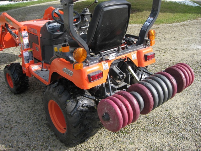

They haven't so far. I think the reason they don't is for them to split, water would have to get inside them, then freeze. Which would then expand and crack the casing. Since they are actually filled with a light weight cement mix, not sand, almost like a mortar mix. There isn't much room inside them for any additional water. They are plugged so there is no easy way for water to enter. In my case, any moisture that gets on them is already frozen. (ie: snow), so if any snow did get inside them it is already frozen and would not expand any further.
You can pick these weights up at garage sales for pennys on the dollar. I have over 400 lbs of them and the make very simple, affective counter weights.
