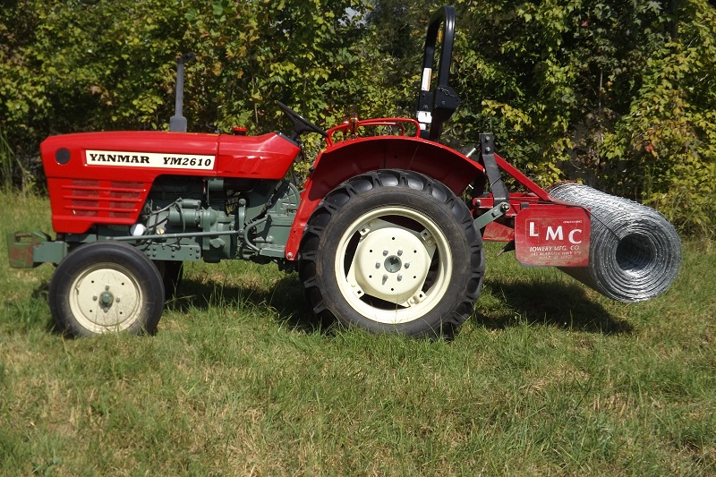

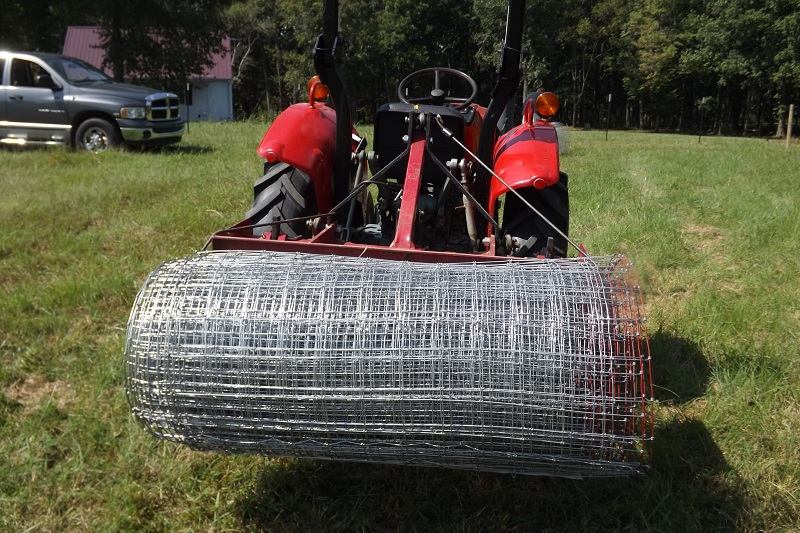

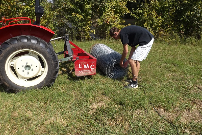

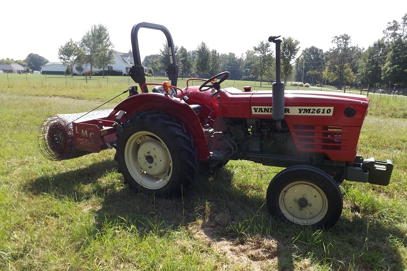

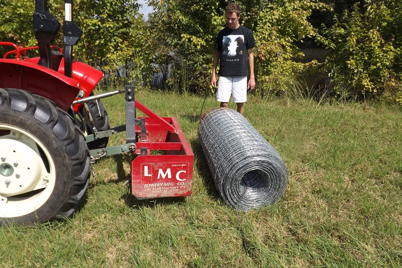

Well, this isn't so much of an attachment, but how to use one in a totally different way.
Again, I used my box-blade for this easy feat. How to lift a 261-lbs 330-foot horse fence roll without breaking your back while moving it across the pasture.
So far, for lifting and moving things without a FEL, the box-blade sure comes in handy.
Take two joined coated 6-foot cables with loops on each end, feed it through the fence bundle as shown, and clip it onto the box-blade. Jump on the tractor, raise the lift and away you go.
