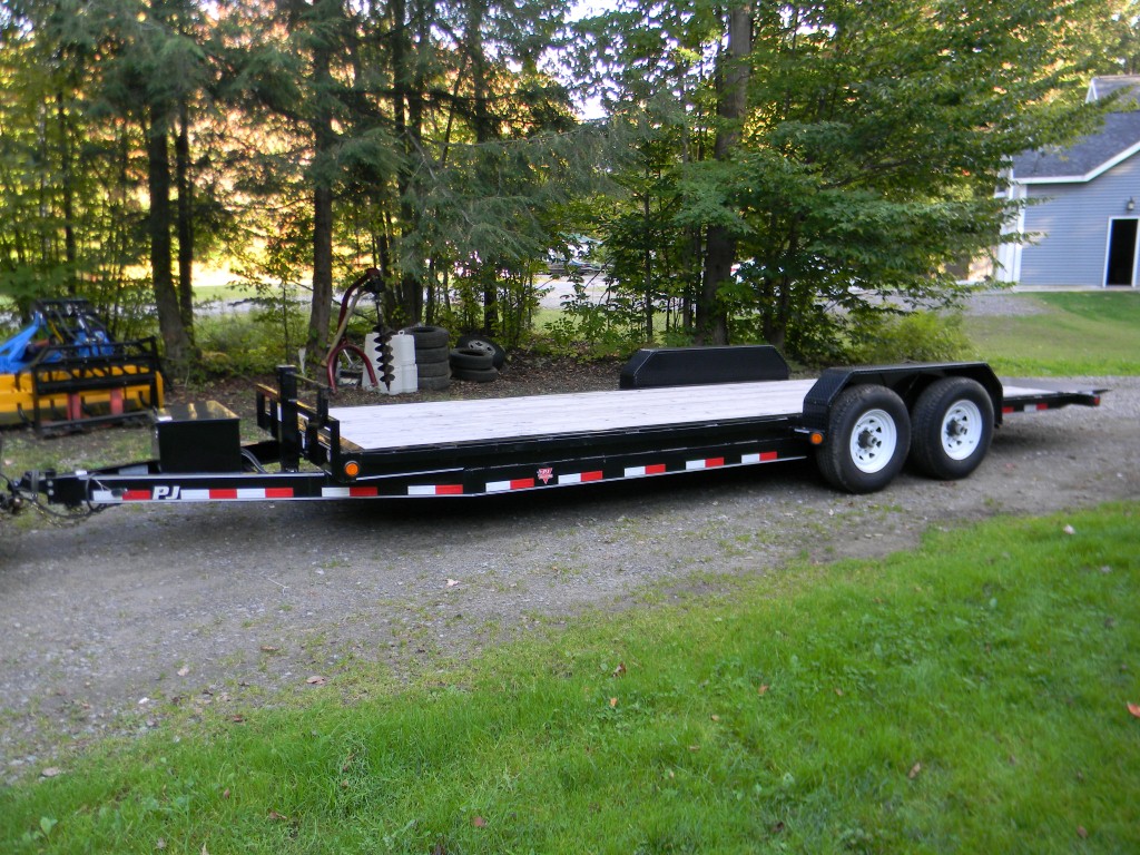

I looked at Bwise tilt trailers last year and thought they were well built. Problem was the dealer didn't have the size I needed in stock and said I'd have to order. I ended up going elsewhere and bought an in stock new left over 2013 14K PJ 22' tilt bed. (Actual length is 23'9"). This and my previous trailer are full tilt bed. For my purposes and the tractors and vehicles I haul I'll take a tilt bed over ramps any day and yes, the tilt beds cost a lot more, almost double a basic ramp trailer.
I also have a 2014 16' Cross Country brand dump trailer.
Extra width of a deck over is nice but wasn't something I needed and I don't care for having things at a higher center of gravity. 83" between the fenders and a 22" deck height hauls everything that I normally haul.
