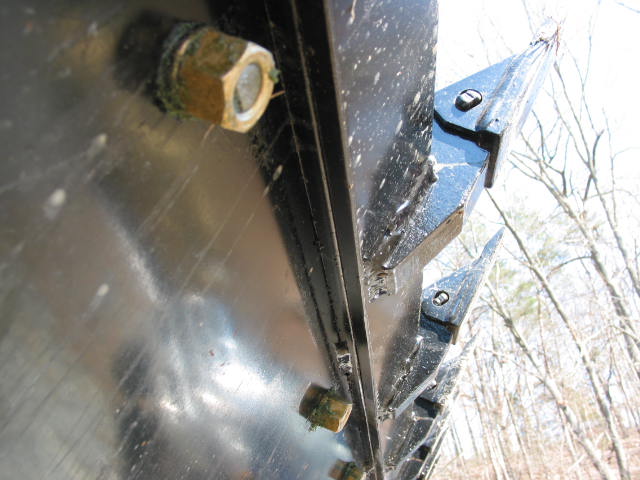

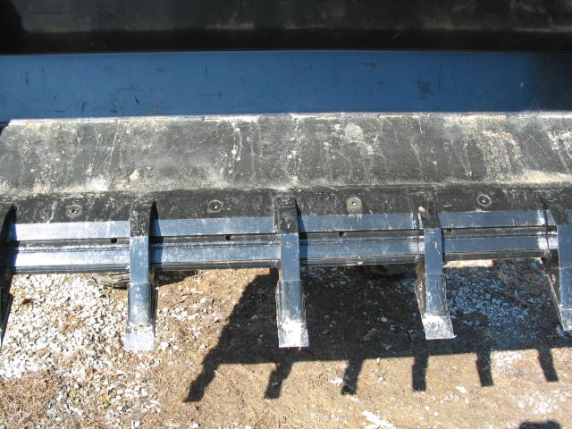

The FEL has a heavy-duty bucket, but it still isn't suitable for aggressive digging. I purchased a heavy-duty toothbar thinking that it was going to be a good solution. The complaints were that it did not fit well against the factory knife edge. As you can see, the fit looks normal from the top.

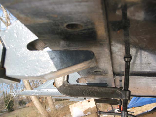

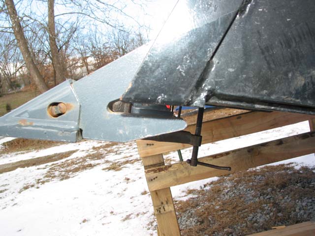

This picture shows that there is approximately .500 inch gap between the toothbar and the bottom of the factory knife edge.

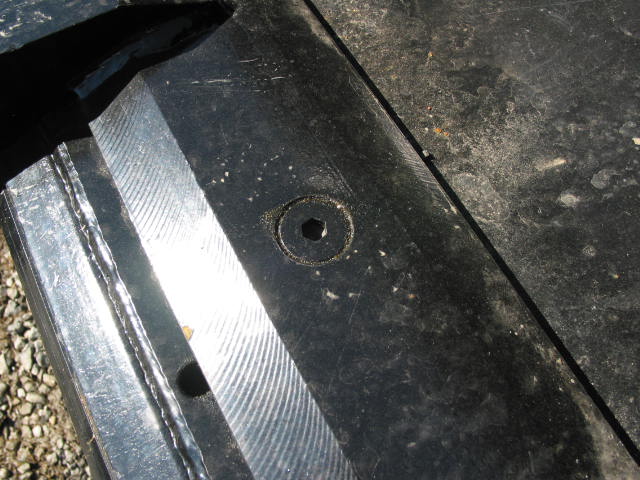

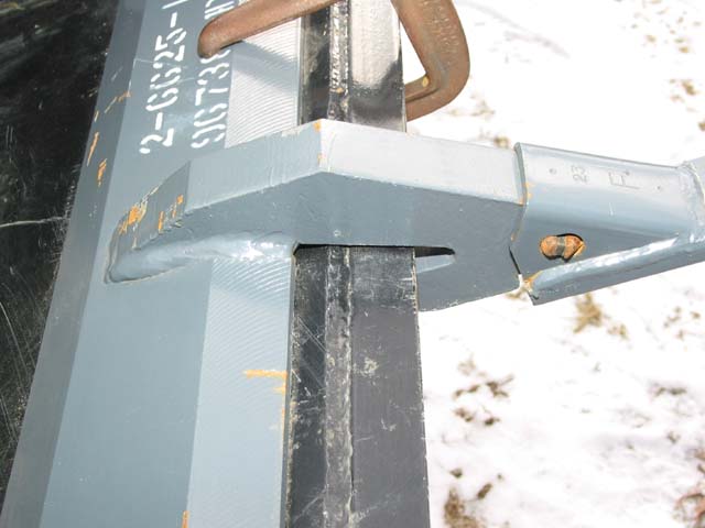

This picture shows the back edge of the factory knife edge. The holes shown were factory drilled and were of no use.

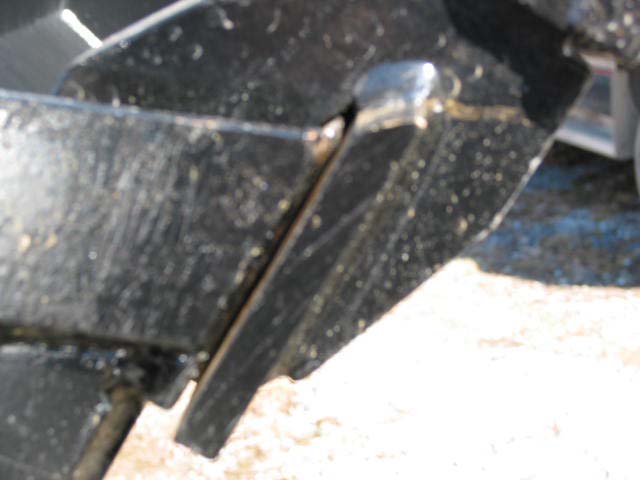

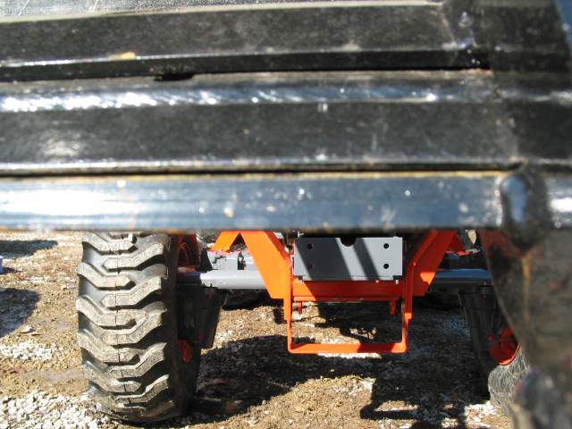

This picture shows a side view of the gap. There are 2 carriage bolts provided by the factory to hold the toothbar in place against the bucket sidewalls. The toothbar mounting brackets are in the inside of the bucket.

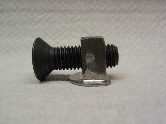

The solution I chose was to MIG weld a piece of 7/16, cold rolled steel, onto the toothbar in the gap area. The new leading edge was bevel ground, not flame cut. Seven holes were drilled in the toothbar frame to accept 5/8x11x2 inch, flathead socket bolts. The holes were counter sinked to a depth that would allow the bolt heads to be slightly below the surface. The side fastening factory brackets were also used with the provided hardware.

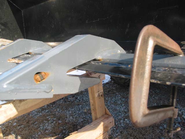

This is a top view of the toothbar, factory knife edge and the new leading edge. Refer back to picture 1 to see the before. Notice that the terminating point, of the bevel on the new leading edge, is only 1/8 inch in front of the factory knife edge.

This is a photo of a simple jig used to safely cut the length of the flathead socket bolts on a vertical bandsaw. It is made out of a square nut and a washer soldered to the bottom of the nut. This jig holds the bolt parallel to the work table. I did not want any threads sticking out past the nuts for obvious reasons. I hope this thread will be of help to somebody. The bucket is solid now.
