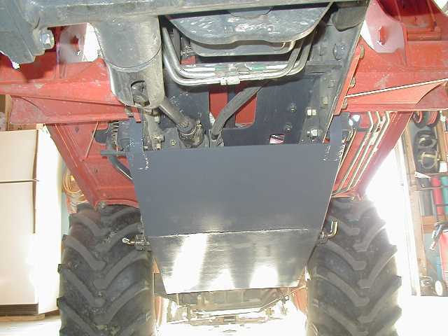

The other thing I'd really look at is building a skid plate. If you are pushing brush, there are a lot of vulnerable parts under the BX, just inviting the flipped up stick to break them! Search here for some great pics of skid plates. Building mine is on the winter project list.

I'd say go with the toothbar, it works great for brush. If going into the woods, I'd highly recommend a plate for the underside to protect the hydrostat fan and the filter, the fan is not a fun job to replace. Here's one I made that just took a few minutes and some scrap. If you need measurements or a better pic, I can e-mail to you. It is off the tractor now so I can get a pic of it.
