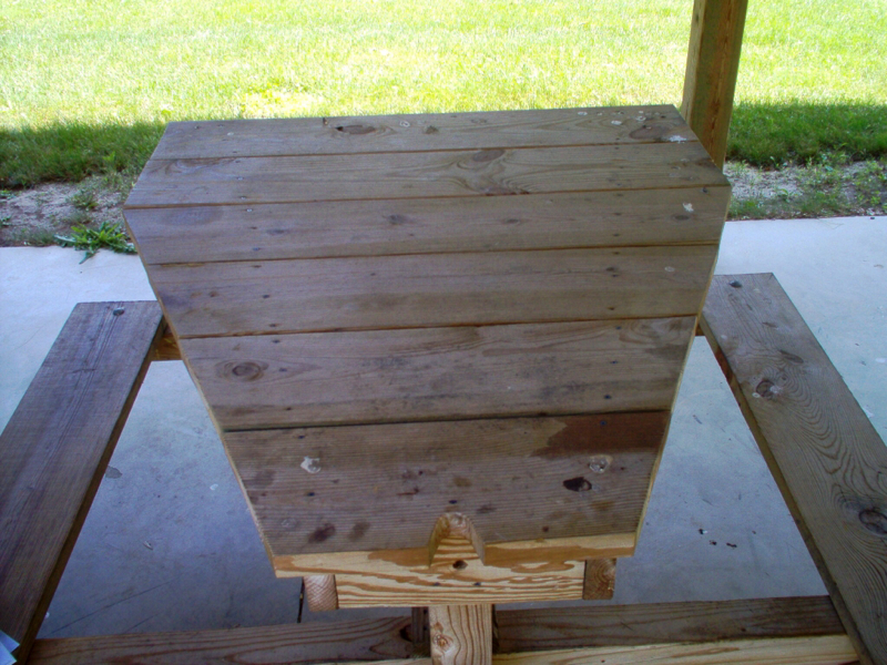

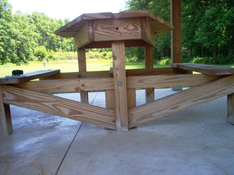

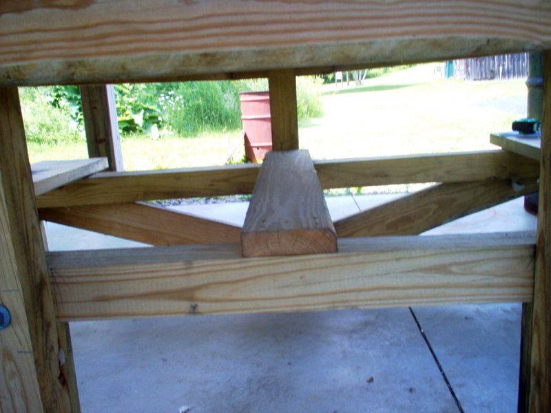

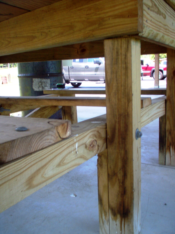

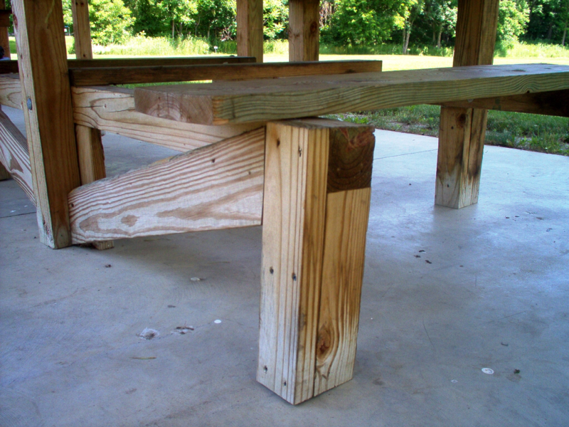

Here are some pictures of a shooting bench I built a few years back.
PT 4x4
PT 2x6
PT 2x4
1/2" Galvanized carriage bolts
Deck screws
All PL's together
Benches swivel to allow you to get comfortable
Took measurements off of a local shooting range
Thanks for looking

That's different. Do you straddle the seat or sit on it like a picnic table? Does the seat move at all once you are sitting on it? Is there enough room for the rifle on that stand with smaller shooters? Kids and women?
Eddie
   / Another shooting bench
That's different. Do you straddle the seat or sit on it like a picnic table? Does the seat move at all once you are sitting on it? Is there enough room for the rifle on that stand with smaller shooters? Kids and women? Eddie
Straddle
No doesn't move once your sitting
Yes
2 shooters can shoot side bye side with this design with plenty of room for supplies in the middle.
Note: will not fit in a pick up box it's too wide

That's a pretty interesting design as it allows use by both left and right handed shooters. It's solid, well built plus it's sitting on concrete. Nicely done! :thumbsup:

Don't know if you can see but there are notches on the top of bench front and back to lean riffles. Sent from my iPhone 5s 64Gb using TractorByNet
