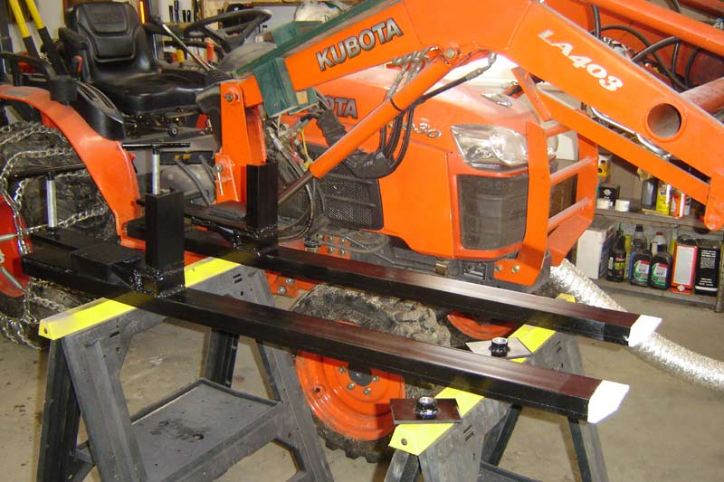

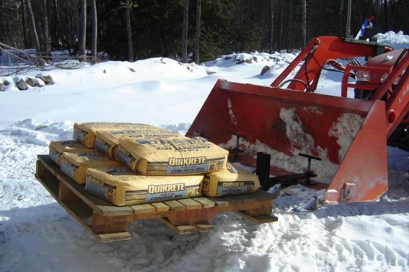

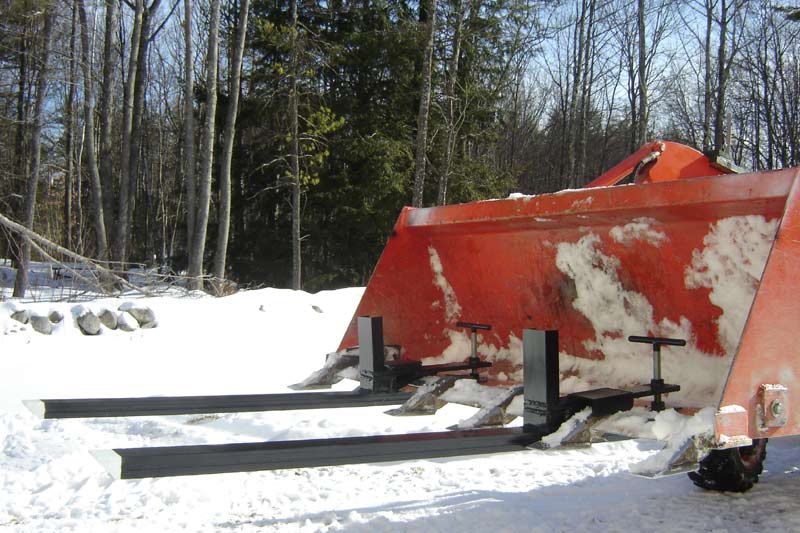

In case you haven't see enough clamp on forks in this forum.
Here is a set of forks I made last week. I added a couple brackets that fit over the teeth on the tooth bar to keep the forks straight.
Vic

nice post.. looks heavy duty..
Vic
Great idea of using the teeth from the tooth bar for stabilization. That way they wont twist on you.
