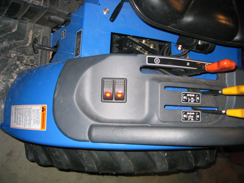

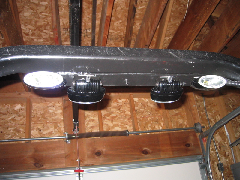

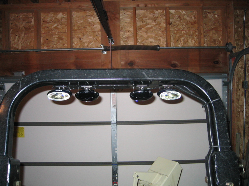

I'm not sure I understand your design, but in my case I took a piece of angle iron and used marine epoxy to stick it to the back of my ROPS. I then drilled into the angle iron and mounted the lights. I have 4 lights mounted, 2 facing forward and 2 rearward. My switches are mounted in my fender and I used waterproof marine switches that are exact matches to the switches on my NH dash. The switches came from Go2Marine.com.
The reason I used marine epoxy to mount the angle iron is because I did not want to risk voiding the warranty on my ROPS by either drilling or welding. Some folks say it is a no-no to do that and to me it was not worth the risk given that there are no-risk alternatives.

Nice solution and work. Did you epoxy directly to the ROPS paint/powder coat or did you do bare metal to bare metal? (I hope sanding your ROPS doesn't start another TBN food fight on warranty/liability issues;) )
   / another ROPS light question #9
Ed, I lightly sanded the finish off the ROPS and left the surface a little bit rough. I did the same to the matching surface of the angle iron. There are a lot of different epoxies on the market, the one I used had a shear strength of something like 5000# and was both waterproof for under water repairs and UV stabilized for exposure to sunlight. I can not remember the brand but I bought it a one of the large box stores. I held it on overnight while it cured with C-clamps. After it was completely cured I painted over the entire thing to match the ROPS paint. Because of the way the angle iron is mounted, the lights not only hang below the ROPS but they are also behind the leading edge of the ROPS so it affords them pretty good protection from branches.
I will say that I did destroy one of the lights and I have since replaced the front facing lights with a different set. While working around small trees a branch got stuck under the ROPS and tore one of the lights off. But even with that, light mounted on top of my ROPS would have been torn off a few dozen times. I have about 1000 Hawthorn trees on my property and they have gnarled tough branches that are just about the perfect height to knock off anything that is not well protected. I'm very pleased with the way my light rig has performed, the epoxy has held firm, and the light placement has worked very well.
