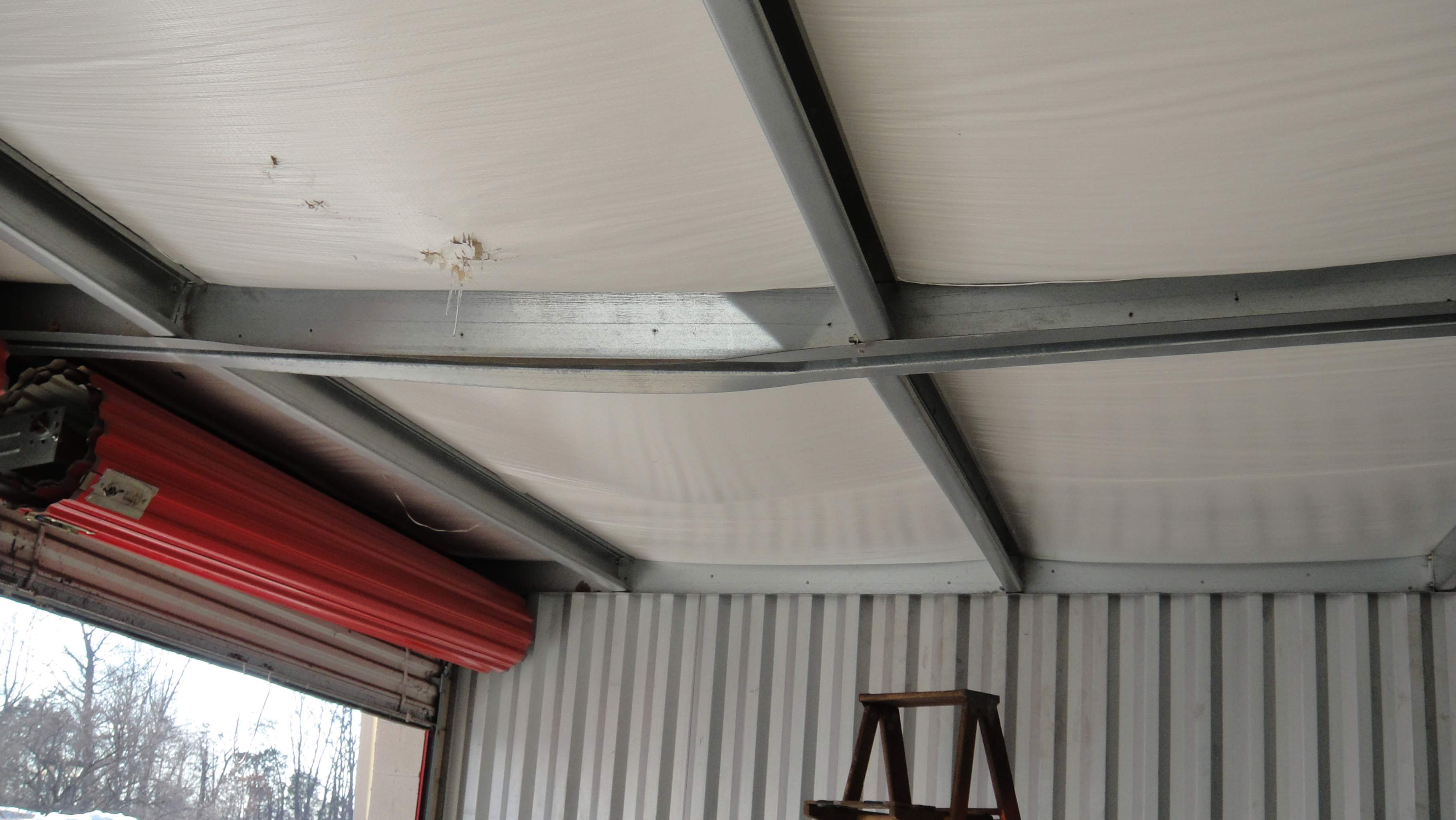

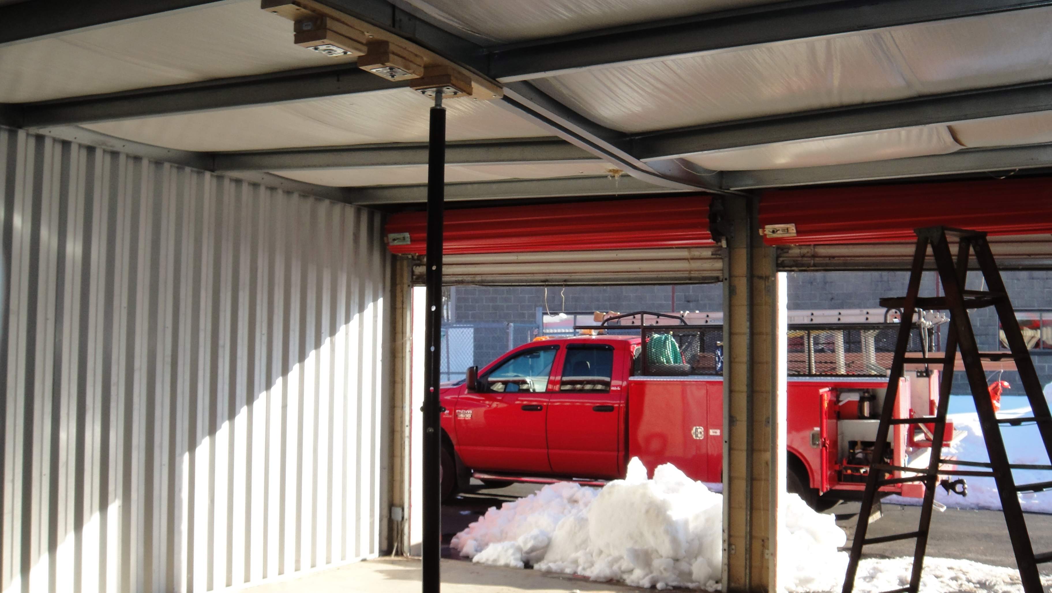

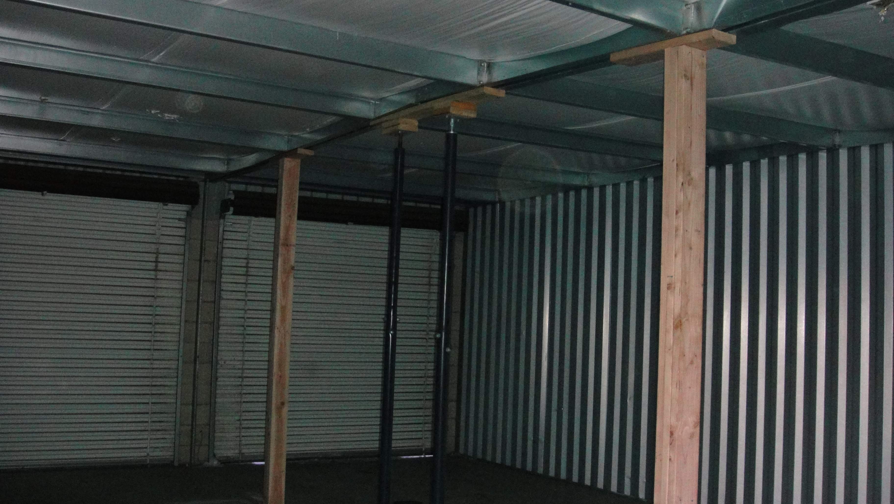

This partial roof failure was in a self storage facility, the renter took out the dividing wall between 2 units to give wide open space. These places are built pretty lightly to begin with but by removing the corragated steel partition wall it was just a matter of how much snow would start it caving in.
We just stabilzed it yesterday with triple 2x6 posts.

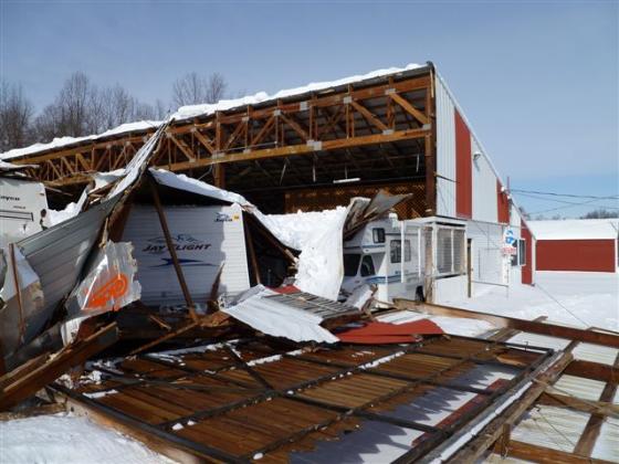

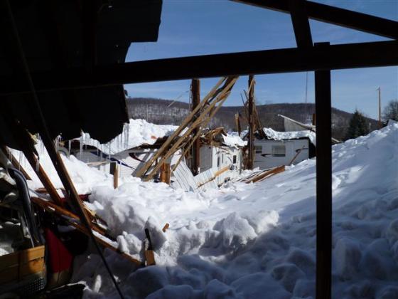

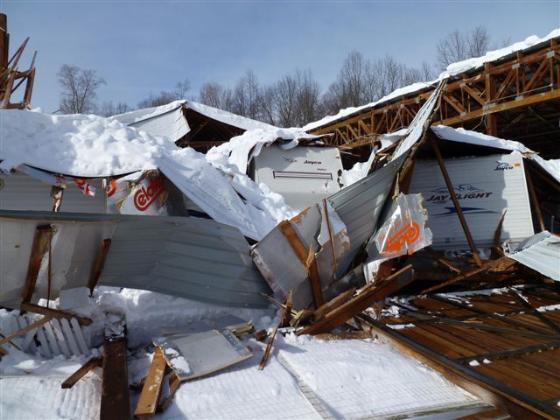

We had a major collapse at our fair grounds this week. The building was the largest building on the grounds and was used for boat and RV storage in the winter. There were 42 units inside at the time of collapse (one of them being my son's camper) and extent of damage is unknown at this time. This is the worst winter for unrelenting snow and ice in many years!
