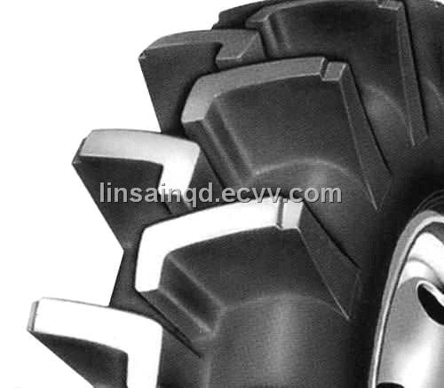

I decided maybe I needed to change my search wording some more and started Googling variations of phrases containing the words; Chinese, Taiwan, Japan with paddy field tires, rice paddy tires, paddy tires, etc and started finding several makers and a wide variety of sizes compatible with gray market compact tractors. The manufacturers are coming up on the foreign import listing sites like "Tradekey" and "ECVV"... they usually list minimum quantities in "container" loads with no prices but I did find this tire available for purchases in lots as small as 10 pairs...but who knows how much they are plus shipping but they are certainly an impressive lug...even for "rice" tires. These things are absolute paddles, click on the thumbnail for a good look at just how aggressive these really are!
Anyway, for the time being, it is a mute point...I already have a new set of R1's coming by UPS and will be here Wednesday. I guess discovering that they are still made and are available in Asia is a start. I wish I knew how strong the market is for grey market rice tire replacements...might be worth investing in a container load of mixed sizes???

Man, those are some impressive paddles! Something like you'd see on the dunes.
Id almost be concerned about too much traction and ripping off a lug? What would those tires be like on hard packed ground?
