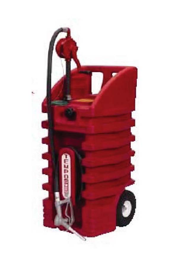

Well, I've been investigating getting a large diesel fuel transfer tank, but I've decided to consider a different and less expensive way to go with this.
Right now, I use a 29 gallon Tempo Gas Walker with a hand pump to buy the diesel and transport it back to my place. I've attached images of it.
I got to thinking about what I didn't like about this set up to see how I might improve it without ditching the whole thing and going to a big tank. The first thing is I'm tired of all the hand cranking. The second is that it's a pain to load the tank unto a trailer and strap it down down. Tempo recommended that I take the pump off, replace the bung plug, and transport it horizontally. That was more trouble than I was willing to put up with. I have a trailer with 3 ft high metal sides, so I just strap it down and transport it in a vertical position so that I don't have to remove the hand pump.
It occurred to me that if I removed the hand pump permanently, then connected a small electric pump between the valve and the hose that you see at the bottom of the tank in the other photo (normally used to gravity feed), then I could eliminate the hand cranking. And since I wouldn't have to disassemble the hand pump every time I transported the tank, I could just load it unto the trailer when it was time to refuel and it would be much easier to secure the tank in a horizontal position. I still have to make the half hour trip to fuel, but I guess I can deal with that. And I would be using fresher fuel.
What do you all think about this solution? Any downside?

cannot really see it being any easier to transport flat.
low flo diesel transfer pumps are cheap enough so wherein lies the dilemma? try it and see....
   / Another question on fuel transfer #3
1*Why not have the fuel delivered instead of going after it.
I have 2 suppliers that will top off my 30 gallon tank whenever they're in my area,
2*Forget the tank for the moment; It's not the problem but the solution is in how you plumb the pump.
3*It's an even bigger pain to unload it off of a truck or trailer.
4*But then you'd have to cart the elect pump fuel filter and hose with the tank when you go to get fuel.
This is why I didn't mount my pump on the tank.
5*Plumb this pump up the right way and it resolves all your issues.
I would not mount the pump to that valve because that attaches the pump to the tank.
