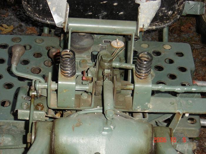

   / Another New Owner / Old Yanmar #7
DSC00823.JPG Did your new seat come with springs ? I bought springs for a small ridding mower & bolted them on . Now my seat has a spring to it instead of the old rubber mounts
Hmmmm, I have a riding mower in the back yard that I could trade the springs out and replace with a couple of rubber mounts.... Hmmmm.... :)
Robert
   / Another New Owner / Old Yanmar #9
I went to the lawn mower supply house & bought new ones & left the ones on the mower
