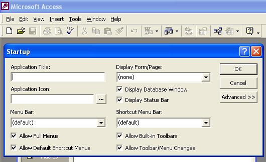

Since a few other people have asked Access questions here in the past, I think I will take a turn...
In a moment of incompetence, I got in a hurry this afternoon, and in my attempt to hide the Status bar, I unchecked the one for "Allow Full Menus" in the database I've been working on for the past two months. Now that the database has since been closed and re-opened, I no longer have access to the "Tools" menu to change this back to the original setting...
Now that the menus are no longer showing, how can I get back in there to re-check the box to show the full menus?
There's had to been someone else out there who's done this who can tell me how to undo it! /forums/images/graemlins/crazy.gif
I will take you to lunch to the restaurant of my choice if you can fix this for me! /forums/images/graemlins/grin.gif
Thanks!

   / Another Microsoft Access Question #2
Tools/ Customize /Options /Show Full Menus after Short Delay?
If I understand your question right
Kevin
Now that I have unchecked "Allow Full Menus",
"Tools" no longer appears in the menu bar to go in and change it back...

   / Another Microsoft Access Question #4
Andy,
Hold down the shift key while opening the database file. This bypasses the startup options. You can then go back and fix the setting.
Great security inside of Access, eh? /forums/images/graemlins/frown.gif /forums/images/graemlins/frown.gif
Dave
<font color="blue"> "Hold down the shift key while opening the database file." </font>
Whew! /forums/images/graemlins/crazy.gif
Tractor by Net saves the day again! /forums/images/graemlins/cool.gif
Next time you're in the beautiful Mahoning Valley, I'll treat you to lunch.
Thanks for the help! /forums/images/graemlins/laugh.gif
