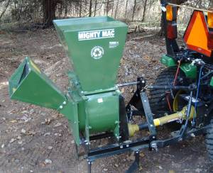

The Mac does everything: limbs, pretty bushy stuff, leaves. It's WAY better for leaves than my TroyBilt was. I often push some fairly bushy stuff into the chipper hopper, as long as the limbs will collapse. Any big stuff that won't collapse has to be clipped and fed into the shredder hopper or fed individually into the chipper hopper. Really bush stuff can be pushed into the shredder hopper, as long as nothing in it is bigger than about 1/2".
It's interesting to hear that a BX-1500 will not bog with it. I've NEVER bogged the Mac down with my 4010; whereas, a similar (shredder-only) Mac on my 12 hp Gravely used to bog down. I'd bog the Troy Bilt a lot; it was only 8 hp. I'm talking about bogs that STOP the machine. The Mac on the 4010 has NEVER been stopped.
Attached is a pic of it on my 4010. That pile behind it is often 6 to 8' tall. However, I often take it to stuff, chip/shred it up and then scoop the chips and dump on top of the pile.
