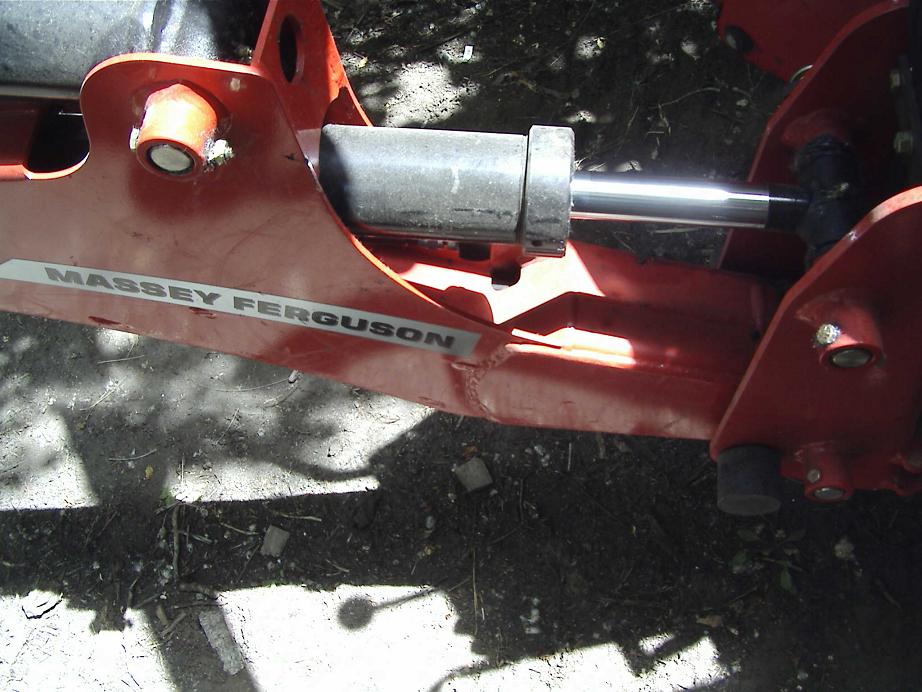

i have to confess, i was talking like a parrot:eek:
a dealer mechanic pointed out that i have all the latest bells and whistles on mine, among other things the backhoe boom. he explained that there was a hose routing problem in the earlier designs that had been remedied in mine. he pointed to the area but i guess i wasn't paying close enough attention.
hope this picture is of the right area, if not just take a picture of yours and i will do the same on mine.:)

I don't have the pictures from my prior post about this a year or so ago, but in looking at your picture, this is what I need. Your hole directly under the jack, is off to one side and would eliminate my hose impacting the fitting on the jack, if it was off to one side. I just called ACGO and reported this, as I have been trying to find away to resolve this issue. I just wonder how many other people out there have an early backhoe with the hose hole directly below the fitting on the jack? If you have an early GC 2610 or GC 2410, I would strongly urge you to look and see if your hoses are damaged, before you end up with a face full of fluid.
   / Another hydraulic leak here on the backhoe of a GC2610 #7
it's odd though, that the hoses are running underneath the whole way down that section on mine.
all is not ducky on mine though either.:(
while dropping the boom to take this picture, i noticed that pretty well ALL the hoses are chafed where they make the turn at the base of the boom. if i recall correctly, that's 6 hoses, and they are all hooped... (or will be soon. 65 hours.)
once again, poor quality control rearing its ugly head.:eek:
they could probably have given a monkee a banana to buff the burr off ten of those cuts.
