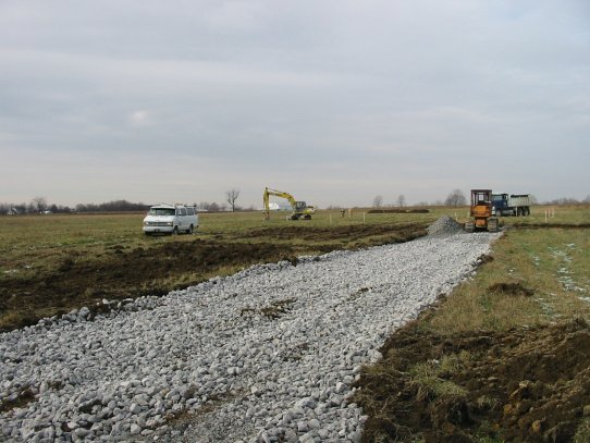

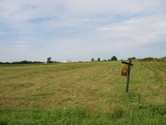

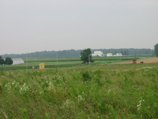

Here is another request for advice so bear with me. I’ve been reading TBN for some time now and have been doing extensive research for a tractor purchase this spring/summer. I have learned a lot about checking out the dealers to see who you are the most comfortable with as well as seeing as many different brands that I could. To date within 35-40 miles of home I’ve seen Kubota, Deere, New Holland, Kioti, Massey Ferguson, Case-Farmall, Mahindra & Landtrac (Long).
My situation is very similar to “City Boy” aka Maury who has posted below with a few different twists. Following this post I am posting a couple of pictures of the property I am building a new house on. As you can see it is relatively flat (4% slope from back of property to road) with no obstacles (trees, etc) but there are some contours I am concerned about such as a couple of natural drainage “ditches” that run the length of the property (900+’) as well as various other holes due to ground hog nests, etc.. The property measures 5 acres. Originally as you can see from the first picture there was overgrowth on the whole property but I had that brush hogged down real close in the fall. My goal is to keep the entire property mowed as I gradually do the landscaping (trees, etc) over time.
I guess as far as my tractor needs go I am interested in a new tractor (HST) and mower (rear mount) to mow the field, I need to plow the driveway (150 foot) when it snows in the winter, I would like a FEL so I could do my landscaping, etc (possibly fill in those ditches and divert the water to drain along property line) and I would like a machine for which I could rent implements such as a power rake when it comes time to put in a finished lawn immediately in front of the house where the contractor has excavated.
Here is where the big question lies....what size tractor do I need? I started out looking orange and the salesman started showing me a BX15!!! In retrospect, at the time (before TBN) I didnt know any better and actually considered that option for awhile. Since then I have been shown New Holland TC29D, Mahindra 2810, Deere 4210, Case-Farmall DX29, Long 33hst up to a Kioti DX35. Now there is a big difference between the BX15 and the KiotiDX35!! Somewhere there must be a happy medium. I guess as budgets go I am prepared to pay $17-$18k if I have to but if I can get away with $10-$12k, more power to me and I can spend the $$$$ elsewhere on the new house. Another issue is the fact that I am tall (6 feet 6 inches) and I need a tractor that offers adequate room and comfort. Sometimes I feel the different salesmen are steering me toward these larger tractors when possible a smaller tractor may do????
Is there a good suggestion in between, like a NH TC 18, 24?? Or comparable orange or green? Or am I better off with the larger machine? I looked at the Kubota Grand L3130HST and along with the Kioti 35 look massive compared to the sub compacts, although they were comfortable. My wife just about had a stroke when we drove by the Kubota dealer and I pointed out the 3130 (we are moving from a suburban development where everyone has 1/3 acre lots and mows by hand or has small lawn tractors)
Am I totally off base considering such a large tractor? I guess one of my concerns is getting something big enough (adequate rear PTO HP) to cut the fields as you can see from picture 2 it is all thick, wild field grass. Also something with enough ground clearance to get over the ditches and irregularities in the property. I guess another issue is the value for the dollar spent. It seems that there is not a big price differential between some of the “smaller” frame tractors and the larger ones.

Here is Picture #1 (land before cleared)

Here is Picture #2 (cleared land)

And last Pic #3 (land cleared, driveway)

I own a B-7500 and my property is slightly larger than yours and looks very similar, I would not be too concerned with the growth in picture #1 it appears to be mostly wild grass and a cutter will handle it with no problem, I let my back 3 acres grow and knock it down 4 to 5 times a year. I would agree with the other posters a 20-25 HP will do what you want, however being 6'3" myself the B-7500 is comfortable enough but the 3130 is much more so. You should be able to get a B-7510 or 7610 with a high quality 5 foot RFM and a light to medium brush hog, a rear blade for snow removal and an FEL for around 16,000 to 17,000 dollars.
