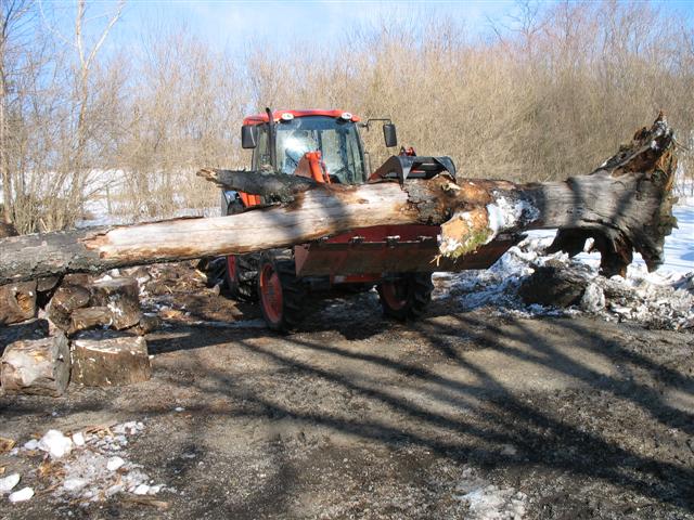

i'm in the market for a grapple for my jd790. most of them i've been looking at are skid steer type attach to the loader. i was wondering how everyone has theirs setup? i also need to use my bucket, i have been considering getting an ati adaptor that allow me to run ss and jd attachments. i plan to mainly use the grapple for brush removal and some forestery use. i ve pretty much narrowed my choices to either the milonzi 48 or the dehner welding 48in. and then getting a set of rear remotes to run the grapple.
   / another grapple ? #2
Do you already have a QA (skid steer compatable) attachment adapter on your FEL? If not, and if you are like most of us trying to get the best bang for the buck, then an alternative to the grapples you mention would be a bucket grapple. There are a lot of guys who are quite content with their bucket grapples. I'd say that they make economic sense mostly if you can fabricate your own bolt on or welded mount using one of the ebay grapple arms (thumb, dehner etc) as the ATI set up will cost you almost as much as the whole Millonzi grapple.
If you already have rear remotes that is by far the quickest and least expensive way to run a grapple. If you don't have rear remotes now, then dollar wise it is a toss up to use that strategy versus putting in a diverter valve on the FEL. Of course if you have other potential uses for the rear remotes that would make sense even if it doesn't save money right now.

   / another grapple ? #8
The grapples mounted on you bucket can work very well indeed. See the attached picture of the Tumb welded to the top of the bucket. It will pick up brush, Rocks, logs or anything else you can grap over

   / another grapple ? #9
Farmerjim, here's a few pics of my ATI grapple, and Fasse valve setup. The forks were made with 2"x4"x3' steel. The setup works great, but if I had it to do over again, I'd get a separate grapple bucket. Prices seem to be about the same either way.
