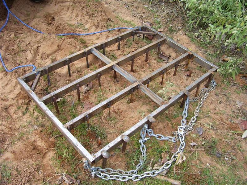

In hindsight I think my little 5'x5' ATV harrow with 6" alternating spikes(mostly head bolts from a 97 mustang!!) would have done just as good on this. But some of the end disk marks were a little deep.

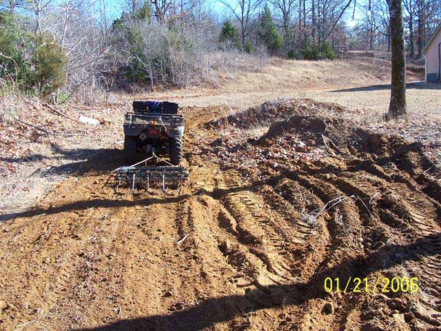

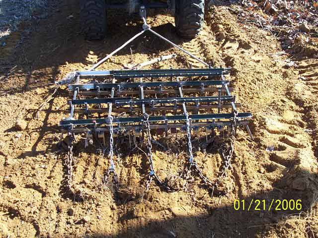

In the end it worked out ok, I got it level enough and went over most of it only once. I just like post some pics and observations and like it when others do the same. I might go back to the ATV harrow because for one it's faster. It'll do the job at about twice the speed. :D
Rob
harrow pics, of course I made version 1.0 and v2.0!!
