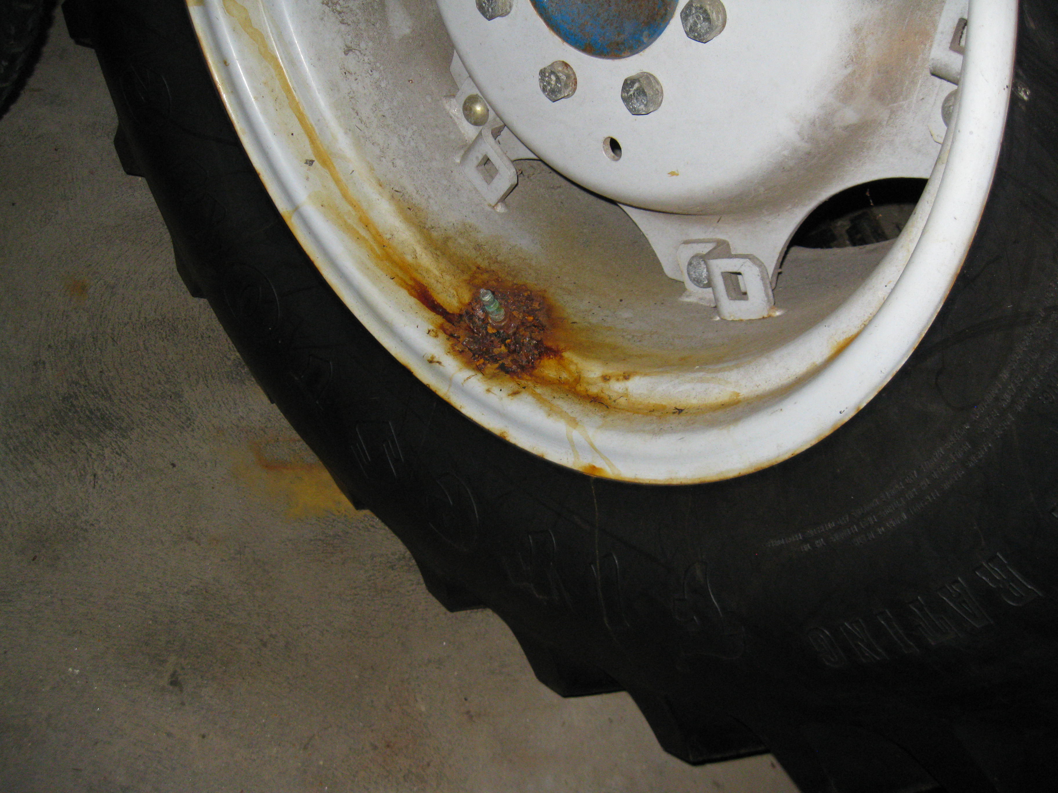

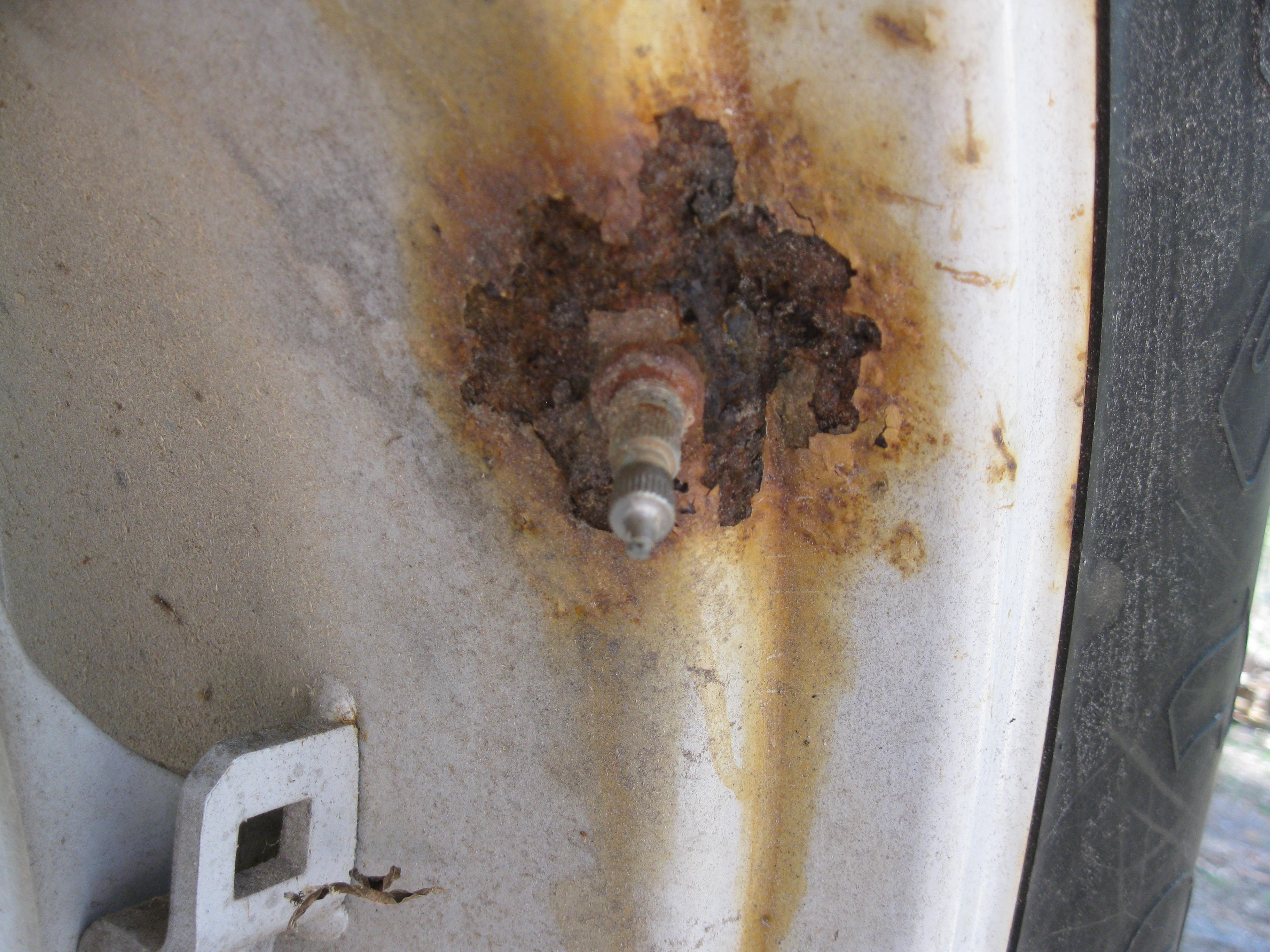

I've been reading the recent (and older) threads about 1920's with tire and/or rim problems, but I can't seem to find answers to my questions. One day I went to use the tractor and noticed a big puddle in the barn, I realized it came from the tire, I didn't change the valve core for a couple years and it completely rotted.
At this point, I figured I would get two new rims, but after searching online I can't find any that resemble the original. The tires are 14.9x24 on a 13" rim. Is it hard to find a 13x24 rim?
IMG_0944.JPG this is the tire that lost ballast, if it lost fluid and air why isn't the tire sitting on the rim?
IMG_0919.JPG tire on opposite side
Do you think it's wise to replace both rims?
The original Ford rims look to have two positions to space the tires. All new rims I see are single "loop." Will a single loop rim provide similar wheel spacing to what I have now?
Should I keep the original rubber or get new tires? The tractor is 32 years old.

I have a 1989 4x4 Ford 1920FEL.
You will not find any 13" rims.
12" rims are given as an alternate, and they are readily available.
You can buy them on E-Bay for $142 ea. with free shipping.
I replaced mine, and used new tubes with WW fluid. No more CaCl for me!
Single loop will work fine, just depends how you position the center plate.

If the current Firestones state 14.9x24 on 13" rim, is there any difference by mounting it on a 12" rim? I assume the tractor came with 13" rims. ( I know I shouldn't assume anything when it comes to what an OEM may or may not do.)
Do you recommend new tires? I'm thinking by the time I break the bead, it could damage the tire.
   / Another Ford 1920 with rear rim issues #4
Take new 12" rims, and the old tires on rims, to Pete's tires in Orange,(275 E. Main St., 978-544-8811) and have them do the swap.
You should use tubes (new) if you plan to liquid fill the tires.
Pete's will tell you if they can do the swap without damaging the tires.
If not, they will have new BKT 14.9x24 tires available.
They were great folks to deal with.

I doubt you need new rims.. mine cracked the metal valvestem at the inside of the rim and mine looked worse than that and tire guy said they were fine I just had the tubes replaced and I kept on going.. if you have the time have them take the tires off then blast and paint the rims.. a little around the hole isn't going to be a big deal..
   / Another Ford 1920 with rear rim issues #6
If your tires were filled with CaCl for many years,(mine were for 25 years) there is a very good chance that you DO NEED new rims.
My rims were bad!

The tractor was bought in June of 1988, so the rims have been tasting calcium chloride for over 30 years. I probably should know why, but if there is a tube, how does the solution come in contact with the rim?
   / Another Ford 1920 with rear rim issues #10
Believe it or not that DAMx CaCl somehow apparently finds it's way through the tube (or people checked the pressure with the valve stem at the 6 o'clock position)
The rust will show at the valve stem only, but when the tire/tube/rim is broken down you will see the rust buildup all around the valve stem edge side of the rim.
I saved my 13" rims, and had the valve stem holes (welded) patched.
I have planned to try to epoxy the 13" rims, and maybe use, or sell them, but that is yet another task not completed.
