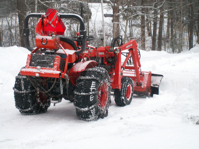

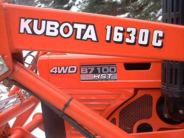

HST would be more easier when using front loader,loader blower you may want rear ballast also rear tire chains for blower use,there no power steering.
B7100HST would be better model.

If you want a loader buy a tractor with one. It will be hard to find a loader plus the corret mounting brackets and hydraulics later on, and would cost you more.
I think you'll do better with HST and 4x4.
Your tire selection may be a problem, You'll want turfs for mowing but they are probably the worst for snow. Keep in mind that R3 turf, R1 farm and R4 industrial tires all take different wheels because the sidewall height and width are different. So you have to swap both wheels and tires.
When I sold my B7100HST a few years ago there were a lot of 2wd ones for sale with R3s, and 4wd ones with R1s. 4wd and R3s are probably less common.
I think my B7100 was a little heavy to be used as a lawn mower (and it had R1s which are hard on the lawn). Weight means more compaction. A dedicated lawn mower tractor might be a better idea. Used ones wont' cost much more than a used mower deck for a B7100.
B7100s came in two model runs, one in the '80s and one in the '90s. You can get parts from Messicks or your local dealer but some parts are getting scarce.

I put 3500 hours on a B7100 hst with loader and mid mount mower.
Those tractors are just plain mules. Steering is hard and will wear out with loader work. Mine had turfs and chains for all four wheels. Turfs are probably the best for your snow conditions. Of course adding the chains makes a big difference.
The mower worked well as did a rear Rototiller. For front blower you’d probably need a mid mount PTO.
For blowing snow a few more HP would not hurt. Might look at Kubota B 7800?
