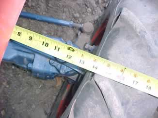

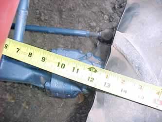

It is a very good thing that DePratt Equip. has my credit card info. on file! I apparently managed to bend one of my front wheels at the lug bolts. I did not actually witness the incident but it had to be during the transportation of a large log on the loader. Now it runs out about 1.5”, enough to rub on the steering arm at one point. I guess the lesson here is that because you can lift it doesn’t necessarily mean you should. Jon I’ll be sending you an e-mail requesting a new front wheel for my LK3054.

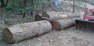

Just some follow up to your replies. It is unfortunately not under warranty. I bought the tractor used. It is a 2000 with about 150 hrs. The logs are between 6’-10’ in length and about 20”-30” in diameter Ponderosa pine. I’ll try to post some pictures latter. I was barely able to get some of the logs off the ground with the loader, actually had to use the terrain to help the bucket curl which should have told me not to do it. I have no problem with ballast. I have a very cool York rake/grader blade/retractable scarfers unit on the rear. It is a monster and has an additional 180lbs on it. I also have the tires filled. My property is steep in places (precipice is a better description) so I believe in keeping all four tires in contact with terra firma at all times.

Here are some photos. This one is of the offending logs.

These next two are of the wheel runout.

And number 2.
