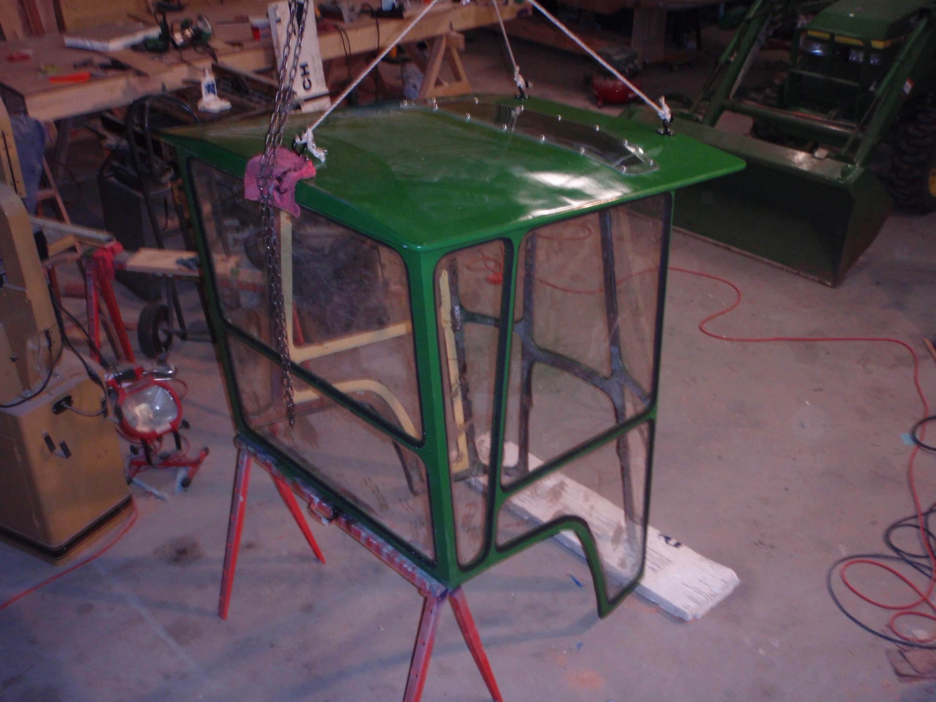

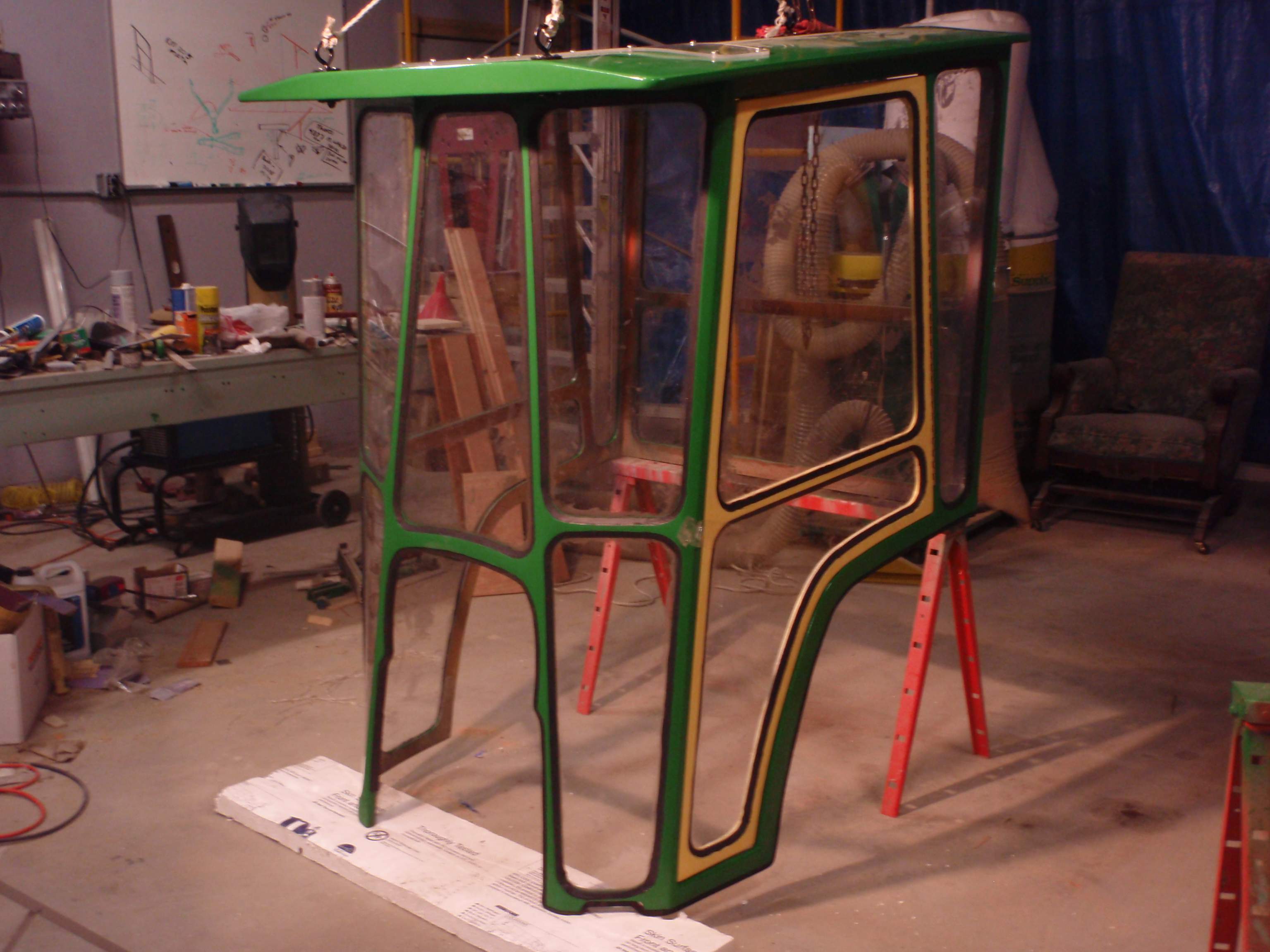

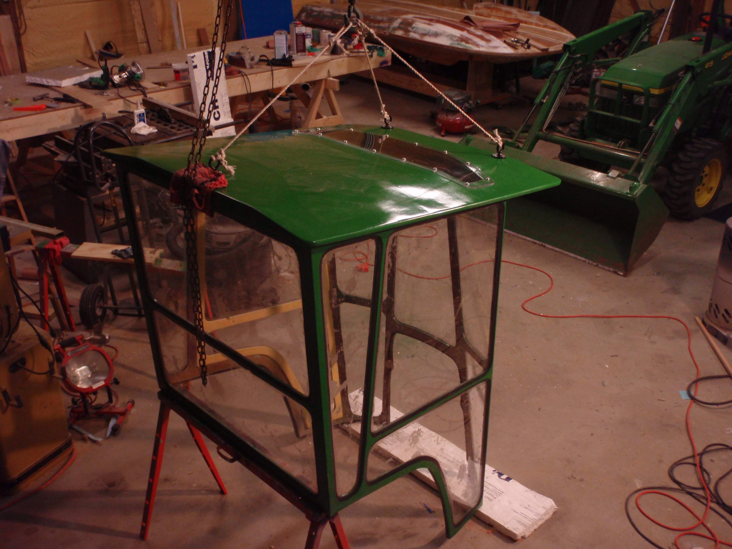

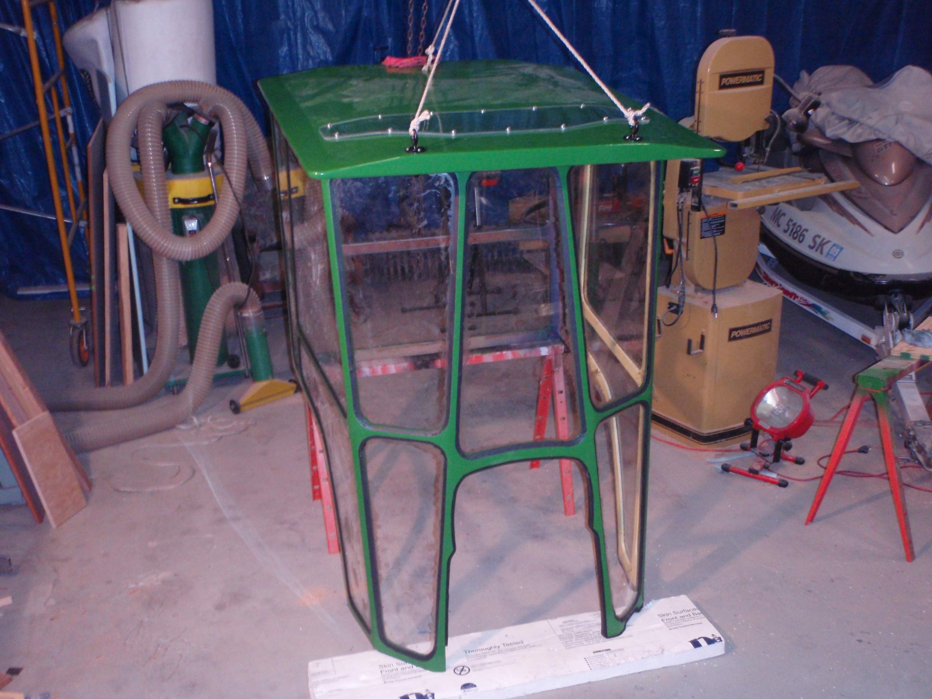

Please see below pictures of a cab I built over the winter for my JD 790. I have enjoyed this site for a couple of years now and got alot of good ideas for the cab and other projects. I built this from straight grained Fir using epoxy for all joints. Also all joints are half lapped and taped for strength. I was able to find some 3/16 plexi for all the window areas. These are all secured with 3M window-weld. I still need a handle and some attatchment points for the tractor but I now am not dreading next winter plowing.

Wow, what a beautiful job. I love the window in the roof - what a great idea to provide that additional visibility.

Neat idea. Wood is so easy to work with involving contours and corners. If it can be sealed properly it would last for many years. It doesn't have the echo effect or sound transfer of steel either.
