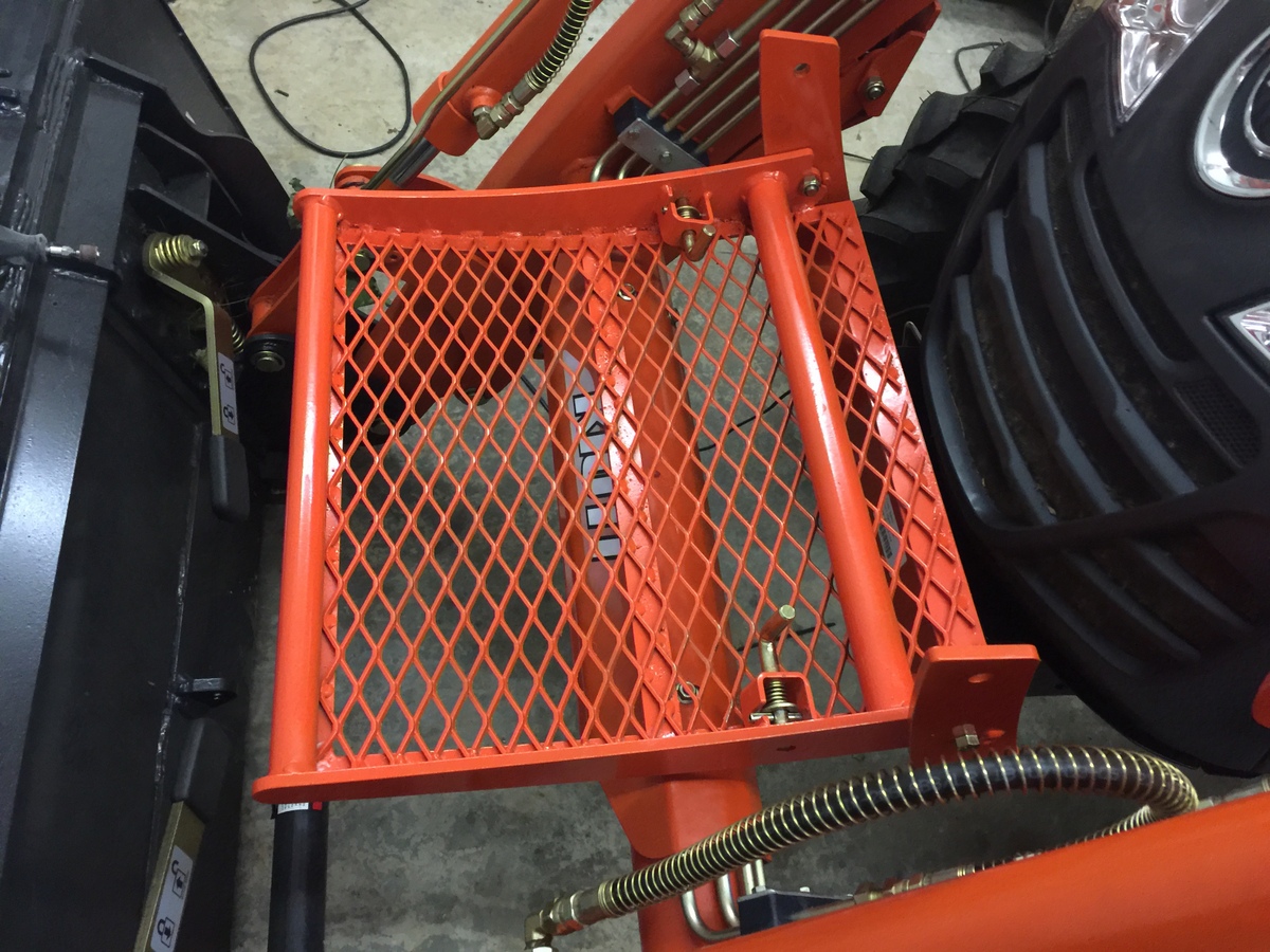

Well, here's my shot at it. I thought I should get it done before I had too many hours on the new tractor (currently 7 hours) . Learned the hard way about making sure the 'L' pins are oriented correctly before installing the roll pin. That Chevy engine orange paint by Rustoleum as recommended by the forum is a great color match too.
I'm trying to develop my metal working skills for working on older cars, so tried to make it look clean. The other lessons learned were 1. grinding metal is somewhat an art if you want it to look good when painted and 2. a sand blaster would be nice to have.
Thanks, Toukow

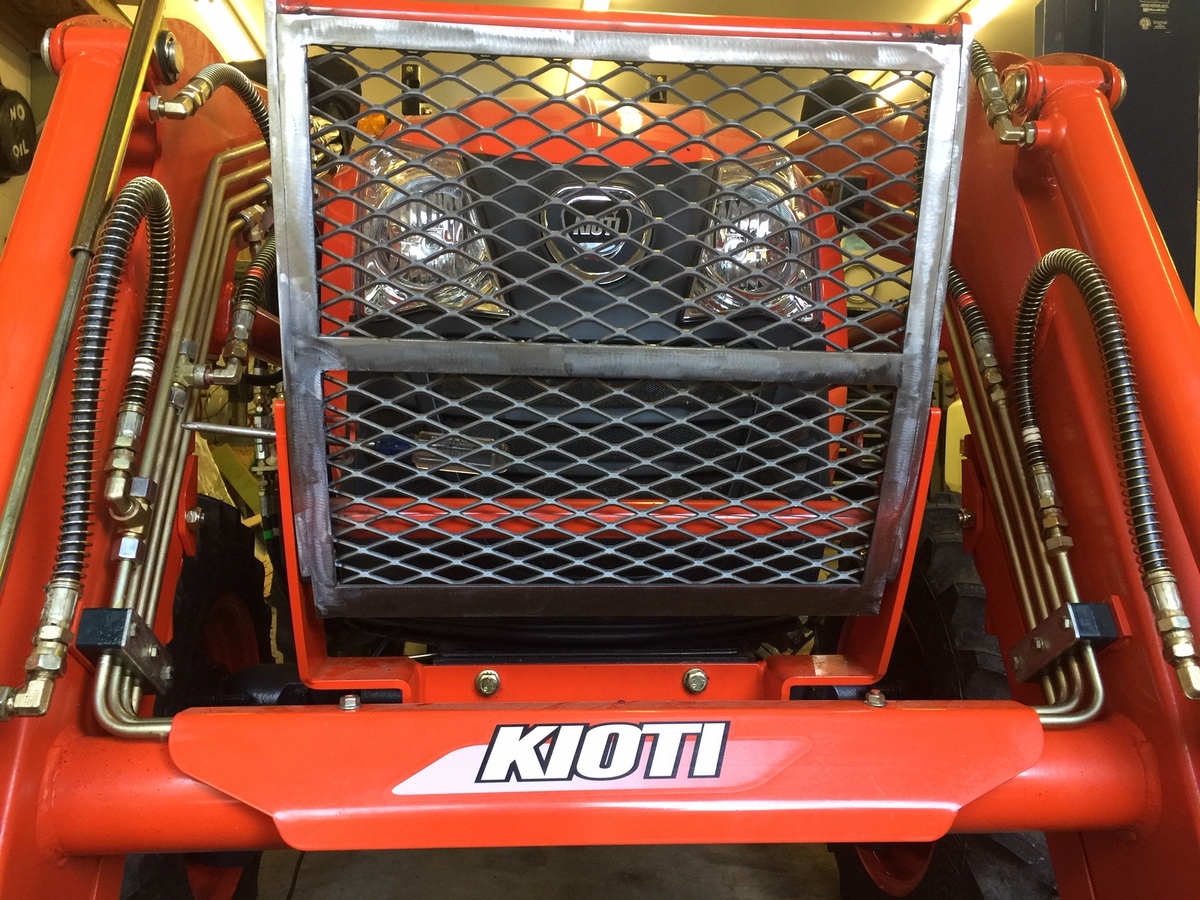

Toukow, very neat work, indeed. :thumbsup: When you have a chance, I'd be curious about the construction. Did you happen to take progress pics?
In particular, how did you attach new guard to the upper "swing away" section of the factory grill guard. Looks like you may have welded it, but can't tell for certain from the photo. If so, I gather you don't plan to use the swing-away feature (not that it's necessary in order to open the hood).

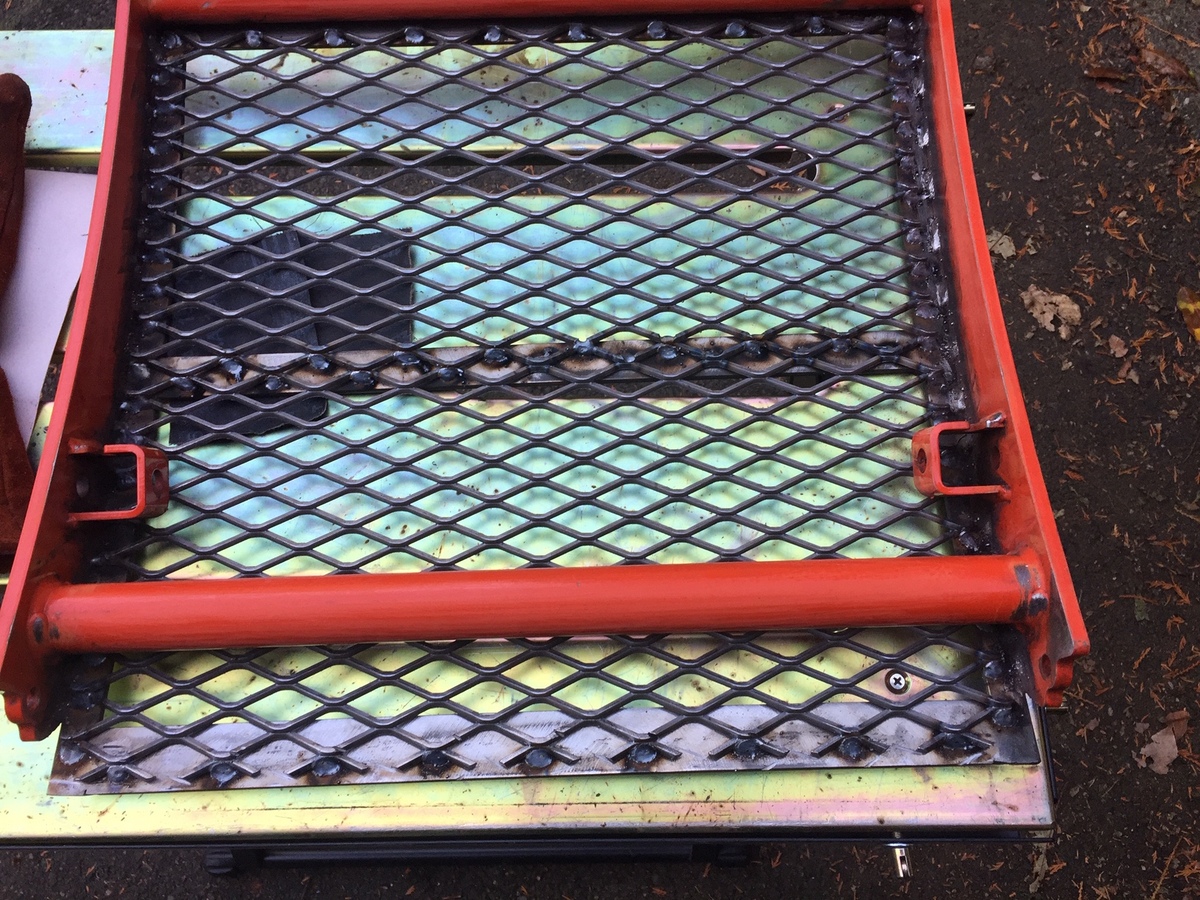

Thanks All for the comments. The frame is back-side welded to the factory frame. The upper cross piece is not welded, but only has about 1/16" gap to the factory cross tube, so is supported when impacted. It would be stronger if welded on the front side too, but I'm really designing for blackberry and brush, not running into the end of 3" diameter logs at speed. I think there are much better designs from a strength standpoint posted on the forum if such impacts are a concern.
The folding mechanism is still fully functional, though I posted previously asking who cares, given as you note it's not needed to open the hood. I originally thought of making a 'Vee' shaped guard which would move the brush to the side away from the face of the grill, but realized it would simply move the brush to areas where it would abrade the hydraulic lines for the loader, so bailed on that approach.
I did extend past the bottom of the factory frame to gain a bit more protection, and could have been left even a bit longer for additional protection. I had to grind off the most forward edge of the pin locking bracket just to have room for the screen to slide by it, but the grinding was minor.
Thanks for reading, Toukow
