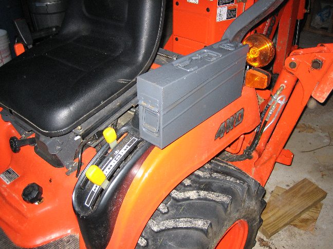

I think I first saw this idea on TBN, but couldn't find it by searching. Basically, it's a simple job of removing the handle on the left side of the seat and putting an ammo box in its place.
I liked Volfandt's(?) box behind the seat, but mine just didn't seem to want to sit just right (and this way seemed easier).
1st pic is with handle removed and plastic spacers being installed:

This box is fairly narrow, so it doesn't get in the way of anything.

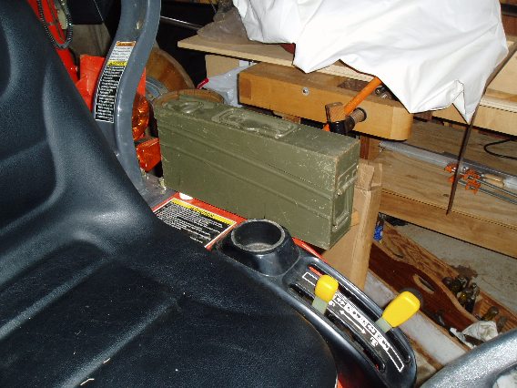

Of course, I had to get a can of ROPS gray ($10), and paint it to match. The dimensions are 3" x 14" x 6.5", and it easily fits a ratchet & a few sockets, adjustable wrench, vice grips, and a small hand sledge, all piled on a rag so they don't rattle.

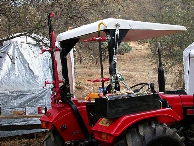

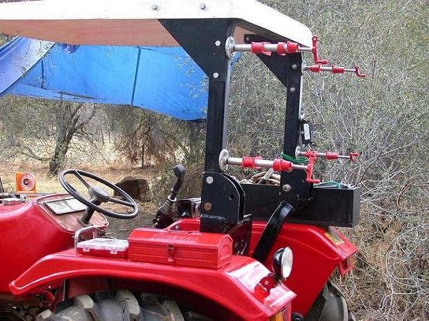

So here's what I did...I added a metel tool box where I keep my pliers, dykes, hammer and file, screwdrivers and that kind of stuff. But working on the tractor out of that box I needed some place to put the hitch pins, cotter keys etc so I added a smaller parts box in fron of it. Then I needed a place to keep my 1/2" drive sockets (2 sets metric & SAE), ratchets extensions, pipe wrench and 2 sets of open end wrenches. So I built a large wooden box that was open and easy to get to. Too bad if it rains, though. I also use that large box to keep 2 sets of chains in.
You can also see on the picture where I added clamps to hold a farm jack and a crow bar or shovel or whatever doesn't fit into the boxes. Of course I also added a drink holder and thermos holder, ashtray etc.

Here's another picture of the clamps that hold the farm jack and pry bar. And also a come-a-long mounted on the side.
