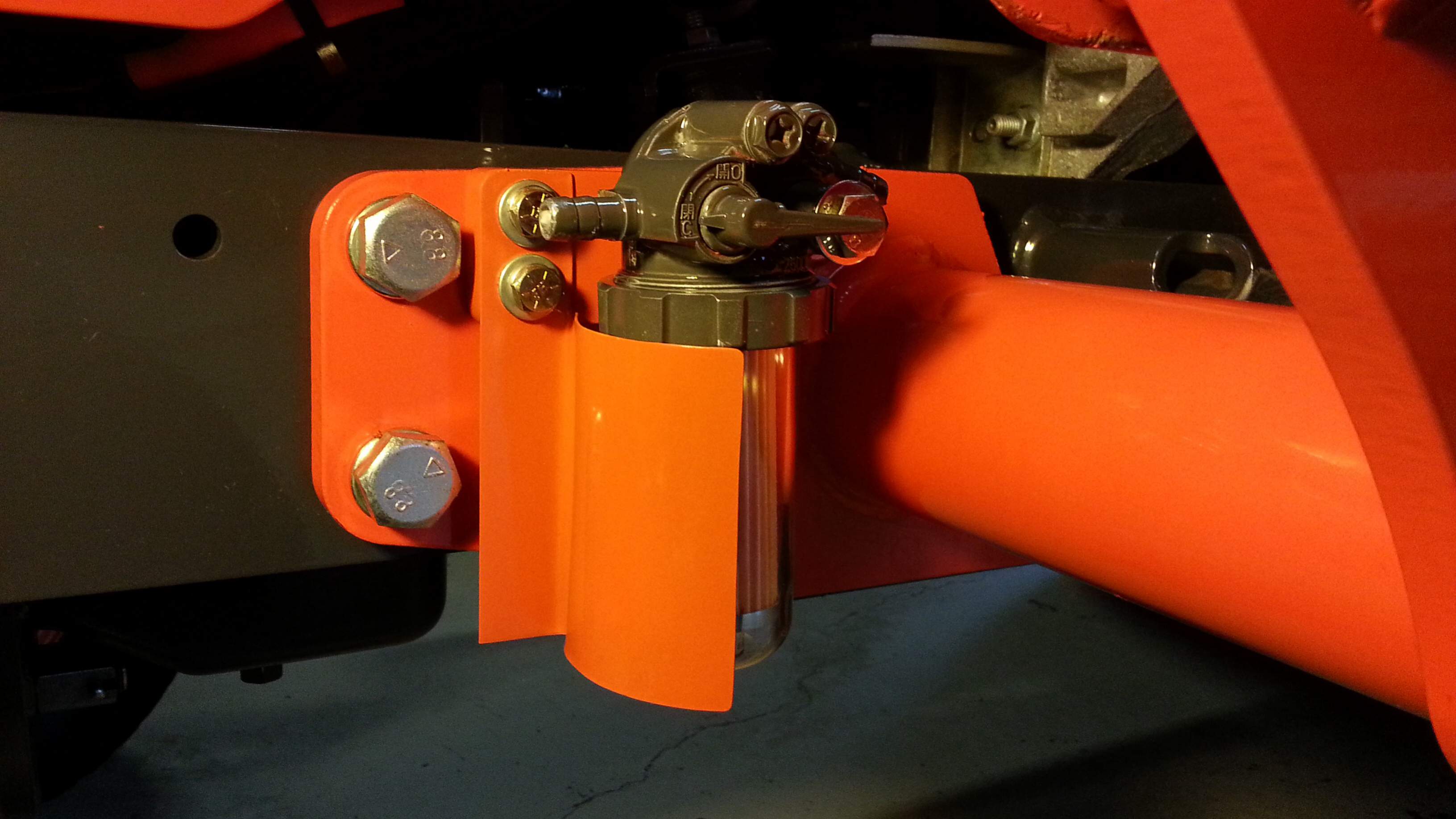

I installed a water separator From a b series. Picked up at dealer yesterday. Still need to run fuel lines. Waiting for snow to be over. This idea was from Paul Short.
