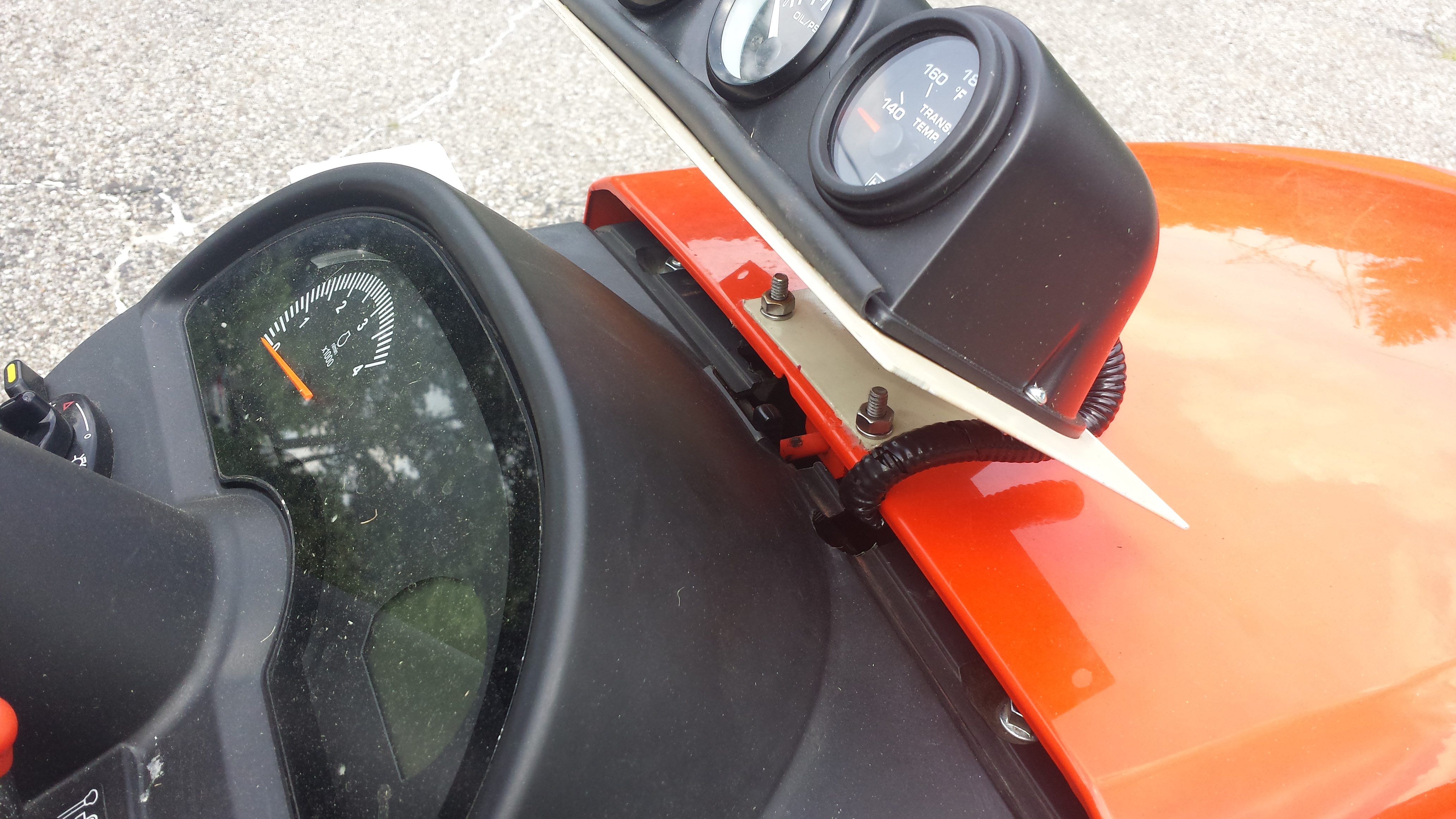

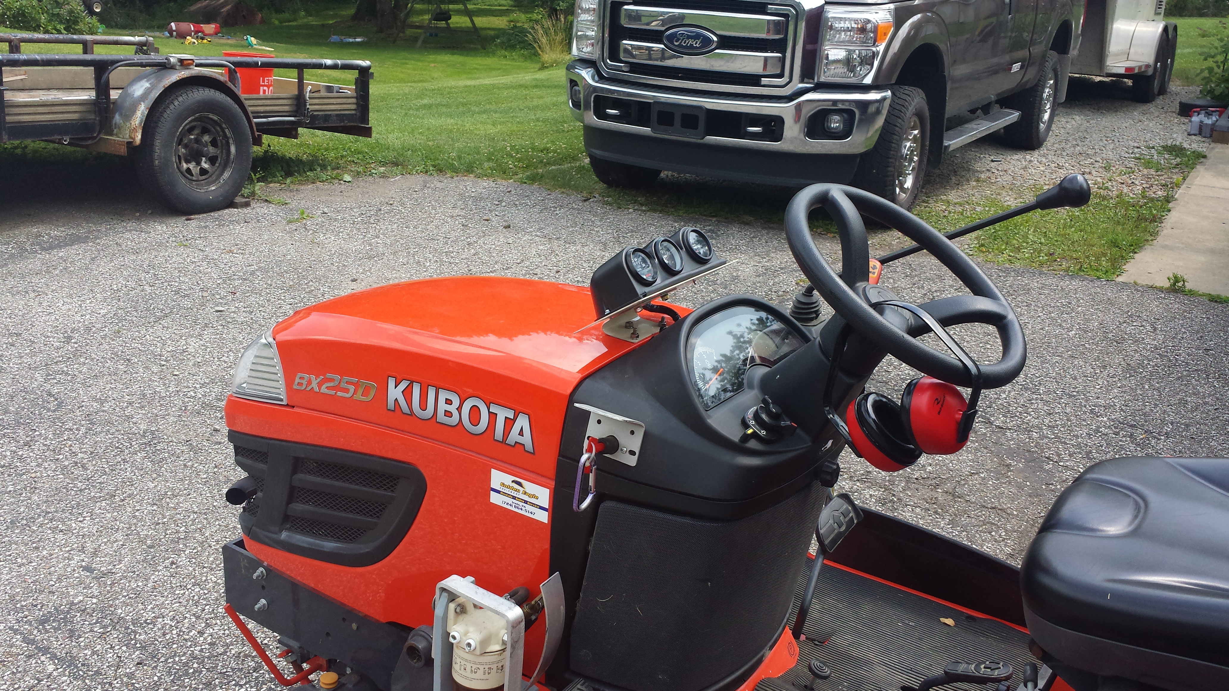

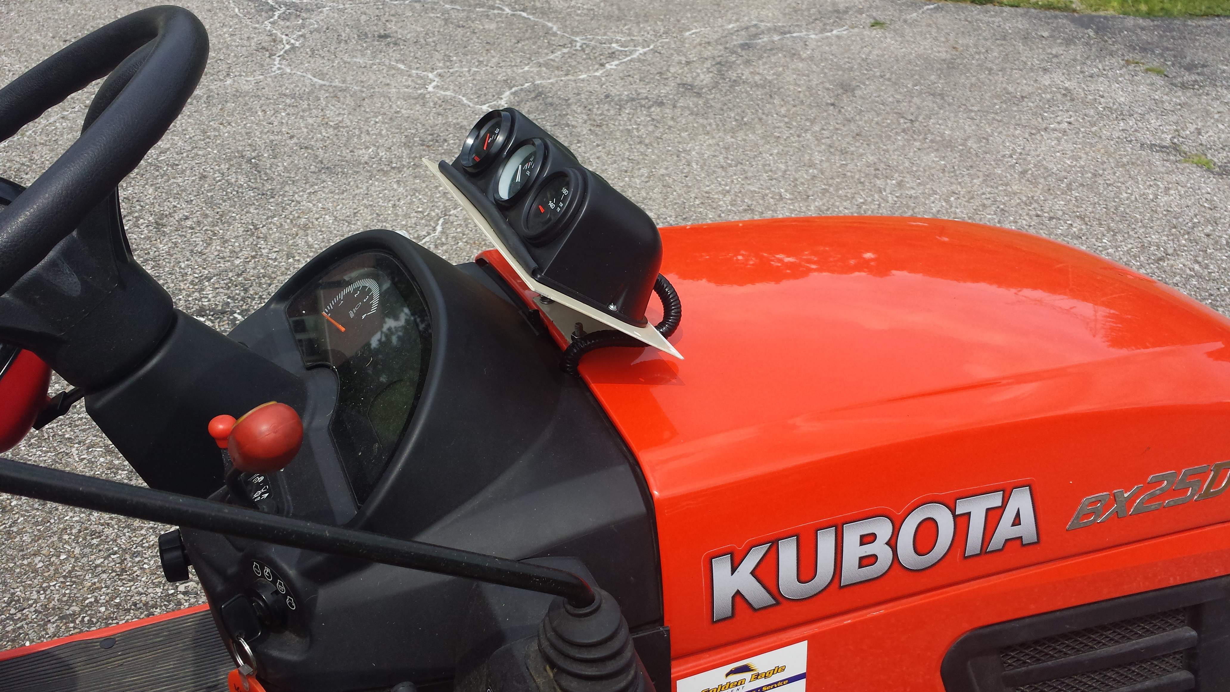

After having all the stuff for the better part of a year I finally got around to
installing an instrument cluster on the BX 25 hood.
I added a volt, Engine oil pressure and transmission Temperature gauge
to a pod located on the hood of the tractor.
All are electrically operated with the oil pressure and transmission temperature gauges having a remote sensor.
I am a fan of old fashion needle gauges with minimal brains.
The gauges supply voltage comes directly from the alternator through a 5 amp inline fuse, It
feeds all the gauges, when not running they will not kill the battery because I have earlier added a battery switch.
Not shown is a Plexiglas cover for wet operations.
With the mower on right now I have not yet installed the transmission temperature sensor,
it will get installed during the cold weather switch over.
I got the cluster pod on Amazon for 13$ and built the bracket out of left overs on hand.
Vibration has not been an issue,
At last I can see what's goin' on!!
My thanks to all the folks on tractorbynet for the great ideas!!

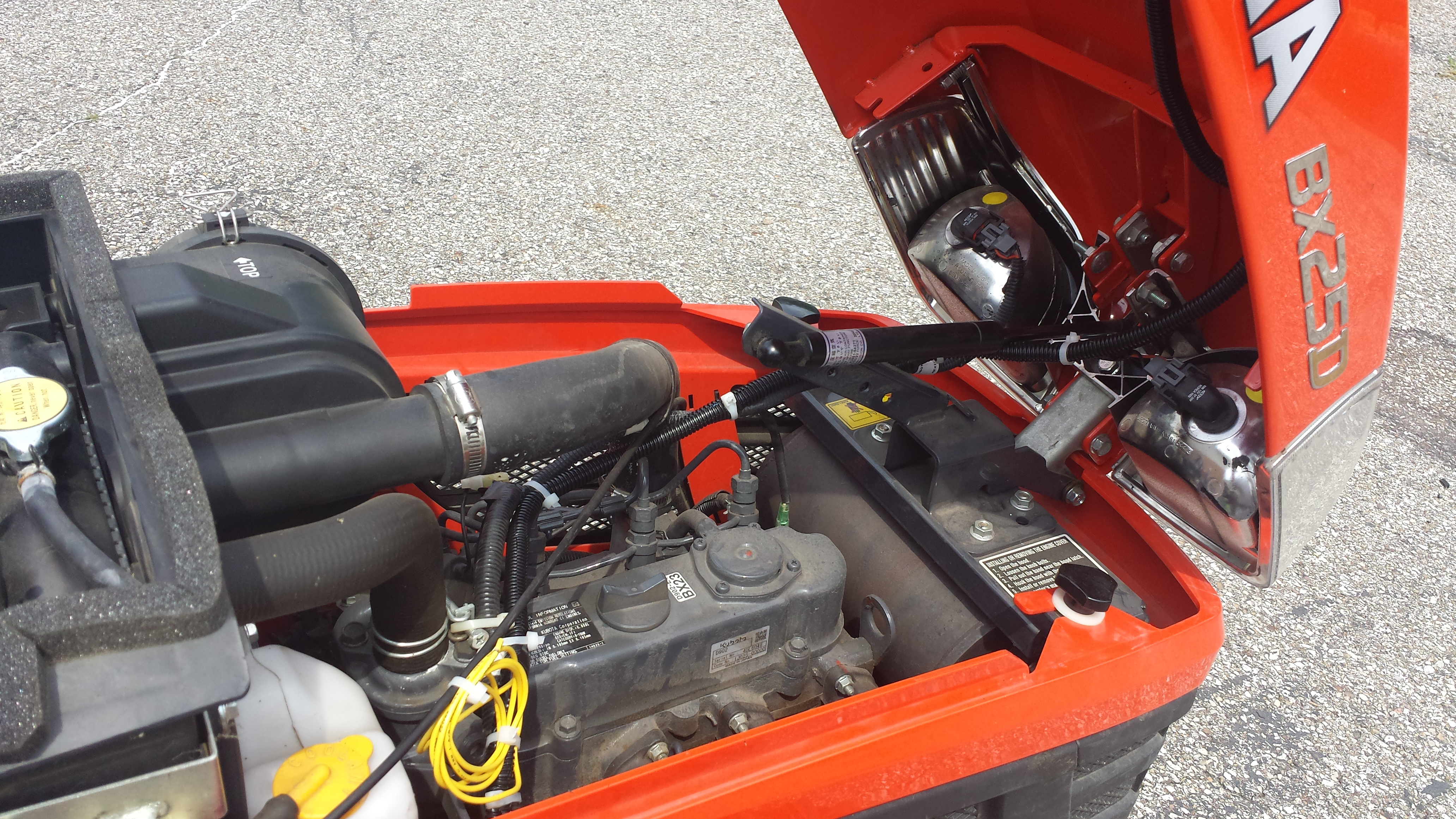

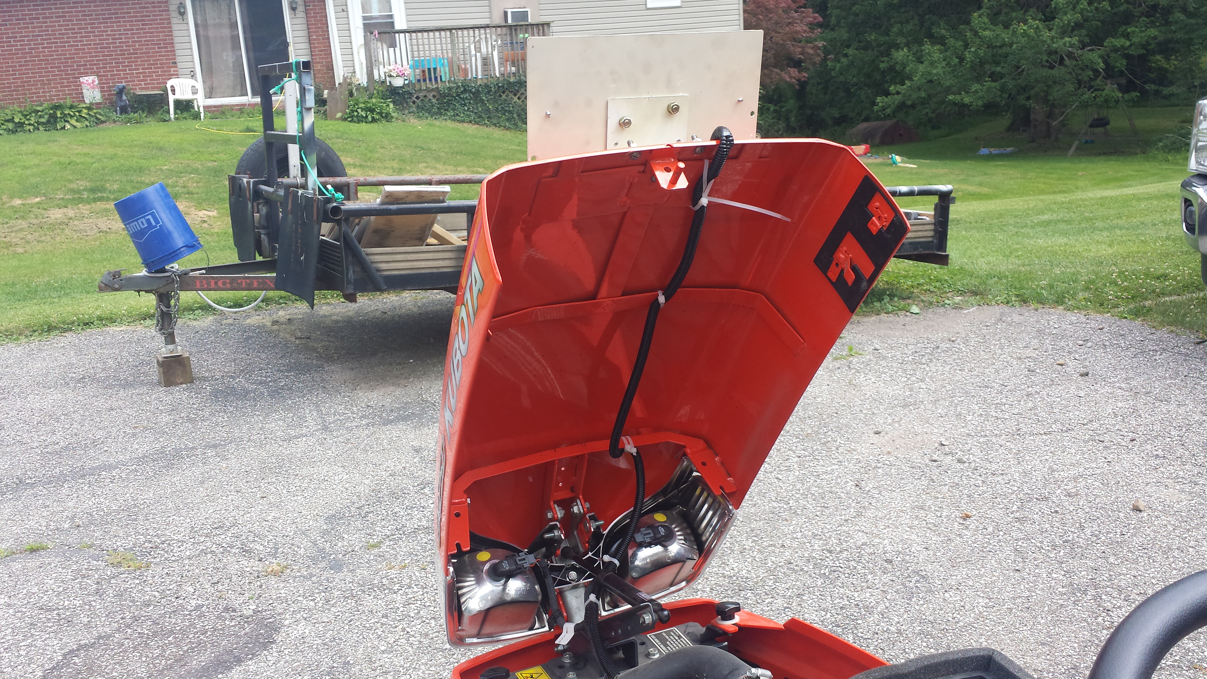

What is your sensor for the HST Temp? Where will you install it? I am interested in capturing that info on my BX. What do you do with wires and capillary tubes when you lift the hood?
Ron
You can see in the pictures with the hood up, those tubes and wires are in the long wire loom routed under the hood up to the front hinge bracket.
   / Another BX 25 instrument cluster
Yes all the wires are in the wire loom under the hood, it joins with the on engine loom already there.there are no capillary tubes.
The sensors are electronic and are wired, they more trouble free in the long run.
Because of the mower being on I haven't installed the Transmission temperature sensor yet.
I will post the location as soon as I find a home for it, I will be looking for a low pressure port that is fairly protected, possibly even the dipstick on the rear.
Sorry I just haven't got that far yet.
