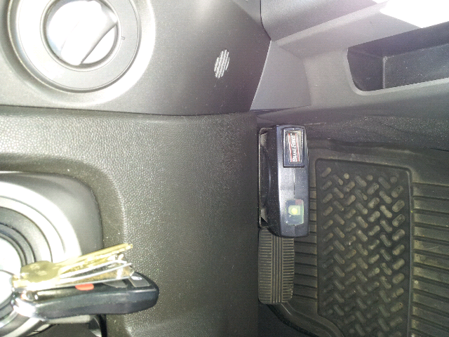

I will take a pick of my controller tomorrow to show you where I mounted it.
Chris
   / Another brake controller question #8
Here is the pics I promised.
Not sure why it rotated.
Chris

Chris,
Thanks for the pic. If I visualized it correctly, your controller is in line with the accelerator pedal. I have a plug (computer plug??) in that position. You seem to have a console over your transmission hump. Mine is open and carpet covered. On the dash at the floor position over the transmission, there is a folding dual cup holder. I can live without the cup holder and may be able to use that cavity for a controller. I will take a pic and try to post it. I have never figured out how to post a pic so I may try to PM you with it.
Also, does the controller restrict your leg movement on and off the accelerator pedal? Can you remove the unit when not towing.
Thanks. You have been a deep well of knowledge on this forum. I owe you a beer or two the next time you are in the New Orleans area.
Norm
   / Another brake controller question #10
Norm, that computer plug is the OBD2 port. I can remove my controller in 2 minutes if I need to get to it. Its used to diagnose the trucks systems if trouble exist which should never be the case seeing its a Nissan.:D:thumbsup:
Yes, I have the top of the line model (LE) with the center shift and bucket seats so that is why there is a center counsel. It does not interfere with my leg in any way.
