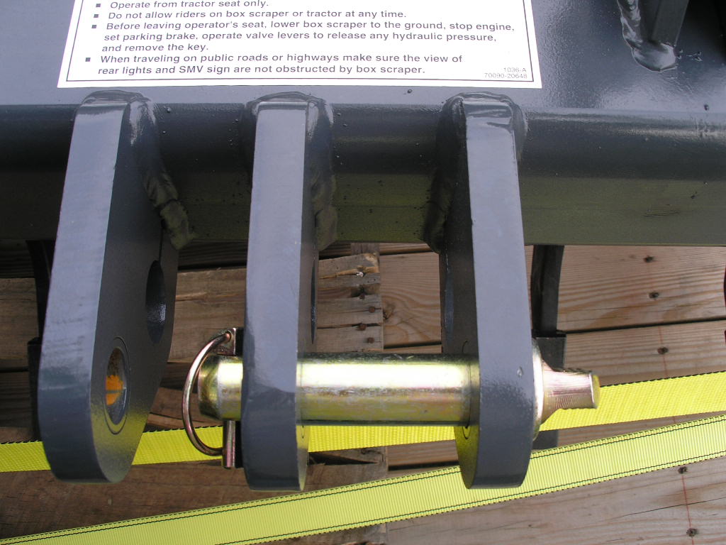

I did some searching and couldn't find an answer so here is my question. I am in the process of looking at 72" box blades. Right now i have a Ford 961 but in the next couple of years will probably also be getting a L3940 which has a cat 1, 3 point hitch. Now with box blades the heavier the better so i have been looking at the "heavy duty" lines which seem to come in a cat 2 set up for the 3 point. Am I correct in thinking the cat 2 pins will not fit on a cat 1 tractor?

You are correct,they are diffrent sizes. You may be able to swap out the pins ,but be sure to check out the distance between the pins to make sure it will fit your tractor. Hope someone else will give you more ideas.
   / Another Box Blade Question #3
Not sure if the 961 is cat 1 but, cat 2 pins will not fit threw the eye holes and top link hole of cat 1. kubota.
I know when I was on the hunt for a box blade, they come pretty darn large and heavy in cat 1.....up to the 1250lb range and a little better depending on brand.... Pins are a cheap swap/adaption option if you can span the width difference from pins from cat 1&2.
   / Another Box Blade Question #4
I think there are plenty of HD box blades out there with both size mounts. Mine is a 72" 1300 lb Gannon with cat 1 and 2.

ditto that. get a hd cat 1 ... neither tractor is cat 2..
