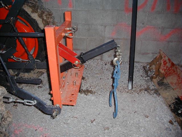

Here is an attachment that I built that I am pretty proud of. Sort of a catch all implement, It serves as both boom pole, receiver, log skidder and anything else I can think of. I do not have a welder so the whole thing is bolted together with 1/2 inch grade 8 bolts. Should hold together pretty well. The frame is made from an old weight bench I had that happened to be made out of 2 inch square tubing. With a few dollars spent at TSC and the local scrap yard and some junk metal I had laying around, the whole thing cost less than 75 dollars. So what do y'all think??

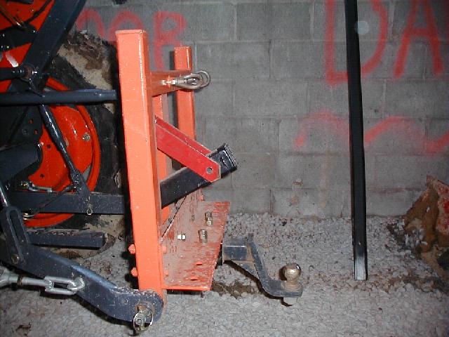

Another view. The addition of a set of skidding tongs and I have a Log skidder that does a pretty darn good job.

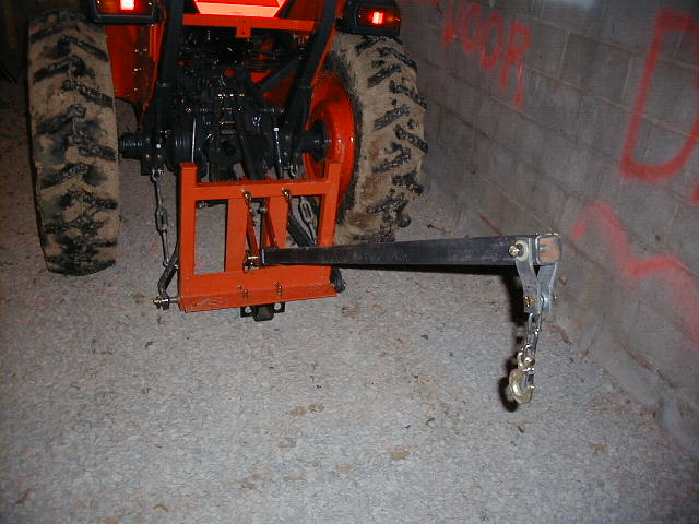

and when I have to move my trailer around......

Hey that looks great. Are there different lengths that you're putting into a receiver? The first pic looks really long and the second really short. If possible, you may want to put a hook in the middle of the long pole for those times that the distance causes you to lose too much lift, but otherwise, it's a great job and appears to be a great tool. John
   / another boom pole attachment
they are actually two different pieces of tubing. In the first picture, the tube is 6 feet long. I had thought about putting a hook in the middle. I just need to take it to a welding shop to have it done. (since I do not weld YET).

Looks better'n the one I built, my log tongs hung on a beam that was an extention of the top link, and tended to lift the front end of the tractor. Your's takes advantage of the 3-points ability to push the front end of the tractor down. /forums/images/graemlins/wink.gif

Nice job...very useful and all without changing the three-point!!
Now if you could just add a coffee cup holder, a radio, and a hook for an extra pair of gloves.....hmmm the possibilities
great job!
