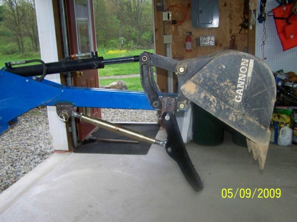

Here is my 2nd generation home-made backhoe thumb, designed for
my Prairie Dog 7.5 subframe-mounted hoe. I posted my 1st gen thumb
last year as some may remember, for this same Woods 7500 clone.
First, for you backhoe owners, a thumb of any kind will be a
tremendous addition, at least doubling the usefulness of this already
valuable attachment. A mechanically articulating thumb works way
better than a fixed one, too.
First photo is of my 1st Gen. I learned a lot from it, so I incorporated
several design changes in the 2nd Gen. I considered going to a full
hyd thumb, since I have used them before, but I do not like the
exposed hoses on the outside of my hoe. Also, the work of plumbing in
another spool valve (foot-operated) would be quite significant.
2nd photo is of all the steel parts for the 2nd Gen. I paid a fab shop to
use their CNC plasma cutter to cut the curved side pieces from my
DXF file. The rest I made and welded (photo #3). Main pivot pin
is 1", and the tip is a piece of plow steel. My 1st Gen used small
backhoe teeth, and even those got quite worn picking rocks.
Finally, #4 & #5 are the fixed thumb, using a std cat 1 adjustable toplink.

Next is the articulated version of my Gen 2 thumb.
For this project, I actually made a full scale mockup out of OSB, so
I could plan the links and the extent of the articulation. Also, I had
to use the existing 25mm pivot at the lower end of the curl cylinder.
This sounds easy, but I needed an extra-long 25mm pin drilled for
grease and a way to drill a 25mm hole in the new link. Also, pin
rotation must be restricted, so a special pin had to be made. Links
are 3/8" x 1.5".
I took a 10 second video with my Nikon, but the file size is 3.2 MB.
I have dialup, so I can not post. Even 5 sec would be 1.6MB. Instead,
I am posting 4 series pix of the thumb articulating. I shortened up
my Gen 2 a bit so it clears the main boom by an inch at full open.
In use I find that I can switch from digging to grabbing very easily
without having to adjust or remove the thumb. Sweet.
Next modification will be to try a slave hyd cylinder, connected in
parallel to the curl cylinder. That may work even better than the
this method.

To ans your ?, my longest link is prob over 2 ft, I don't recall.
The thumb moves extra-fast when nearly closed, as the angle
betw link and thumb gets quite acute. I am not sure about what
you mean by a resting place...you mean disconnect it? If so,
no, there is none with out pulling links. I found that with the
Gen 1 thumb, I dug with it in place, too, rather than getting
off my lazy a55 and removing it. It even came off in 5 seconds. I did
find the thumb actually assists in digging. Much more so with
Gen 2, so I do not anticipate disconnecting it. I have too many
rocks here anyway.
I tried different kinds of pin retainers this time. Anything exposed on
the sides of the thumb will be destroyed, as you will find.
I did not even consider a link in the middle of my kidney link, as you did,
since mine are cast and have large concavities on their outboard sides. I
also did not want to weaken them, esp since they are cast steel.
I never considered hanging most of my linkage below the dipper as you
did, since that is where most of the "dirt action" is.
I am about to order some more toplink cyls, so I will get to try my
4th type of thumb soon.
