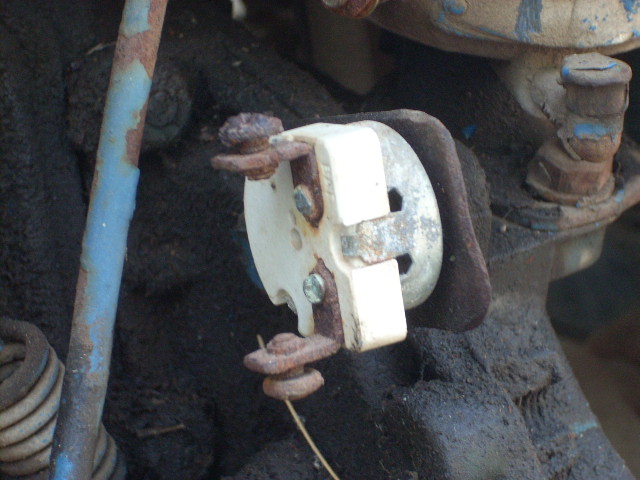

I picked up another sidemount project tractor yesterday.
It been converted to 12volt. It doesn't run but I did get spark so I'll work from there.
I found two things right off that I had questions about.
The first was a ballast, switch type looking thingy mounted below the distributor.
My guess it's a 6 volt light switch?

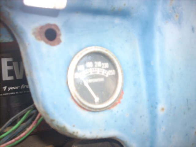

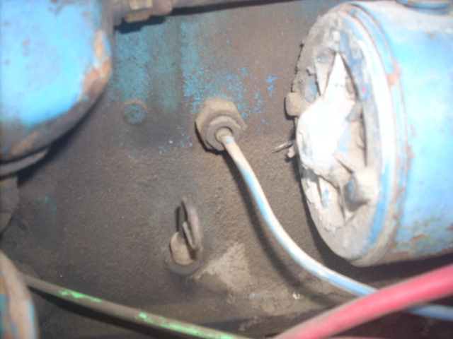

The other is a temp gauge mounted in the dash. It has a very long wire that's folded over a few times.
I'm wondering if I'll be able to shorten it?

most temp gauges use a capilary tube and it cannot be cut.. if your auge instead uses an electric sender and a plain wire.. then yes.. it can be cut.. my guess is you have a capilary tube type.
the ballast resister you see near the distrib was the prev owners fix for using hte 6v side mount coil on 12v. loose the resistor and instead install a real 12v coil like a 16$ NAPA IC14SB.. that is, if you intend to stay 12v.. etc.

3. Temp did not function. that line is part of the birdsnest that I need to reroute.

I think you're right about the temp gauge type.
On the resistor, it is no longer wired. It looks like it's been that way for years.

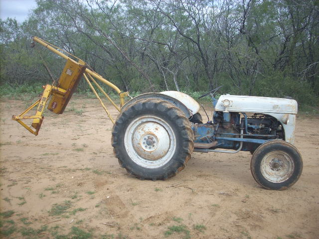

I got my lift working today. I'm embarrassed to say how easy it was.:eek: Still needs work though. It pulses on the way up, raised and held the six foot blade, then took about 30 minutes to bleed down from high position with the motor off. It will do for now.
I think she's gonna like her new home. She sure ain't feeling neglected anymore.:)

sounds like your hyds are about as good as probbaly 80% of others.. holding 30m is great.. pulsing going up on a heavy load and a lil knocking is indicative of normal wear...worry more when it stops knocking..
