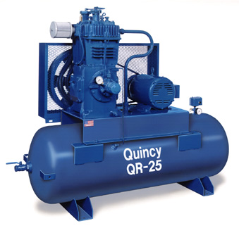

I am getting around to finishing the wiring in my new garage (the old one is full) and I want to install my 5 HP compressor in there. I have found the motor specs here on this web page. Now my question is, what is the correct size circuit breaker for this application? I would also like to wire this with a twist lock plug since the compressor is skid mounted with wheels.. (makes for easy cleaning of floor). I would like to know the correct NEMA twist lock plug to use for this application. It is presently wired with 12 gauge wire, however, I am not certain if it should be 10 or 12 gauge. Is 12 gauge adequate? Thanks for the help..

But at 23 full load amps, I would put it on a 30 amp double pole breaker and you should replace your 12 guage wire with #10. 12 guage is only rated for 20 amps while 10 guage is rated for 30 amps.

For the twist lock 220 V, 30Amp
Look Here
"L" equates to locking and the L6-30 is a good choice.
Is this a test?? /forums/images/graemlins/smile.gif
   / Another 220 Volt Compressor Question... #4
L6-30R for the receptacle and L6-30P for the attachment plug.
#0 Amp circuit......#10 wire
Hope this helps. Hope I passed the test as well /forums/images/graemlins/smile.gif

You might want to consider 8 gauge conductor and a 40 amp breaker. Continuous run amperage on a true 5 Hp motor is approximately 23.5 amps. The cost of 8 gauge wire is not much more than 10 gauge wire. If a 30 amp breaker trips on continuous run, then you could swap it with a 40 amp breaker and have the proper gauge conductor in place. You will have more plug choices also.

I am using #10 on a dual 30A breaker per code. It works fine for my large compressor with a 7 HP motor. I looked at the spec for the motor that you listed. 89 Lbs !! WoW I don't believe mine is that heavy, but I've never removed it from the tank.
I don't think you will see much benefit from using #8 wire, unless you are making a long run of 100ft or so. You should use a 40A breaker sized properly for the supply wire if you should use #8. I think most people jump to a 50A, #6 circuit at this point. I suspect the terminals in the compressor relay are not sized for this large wire.
