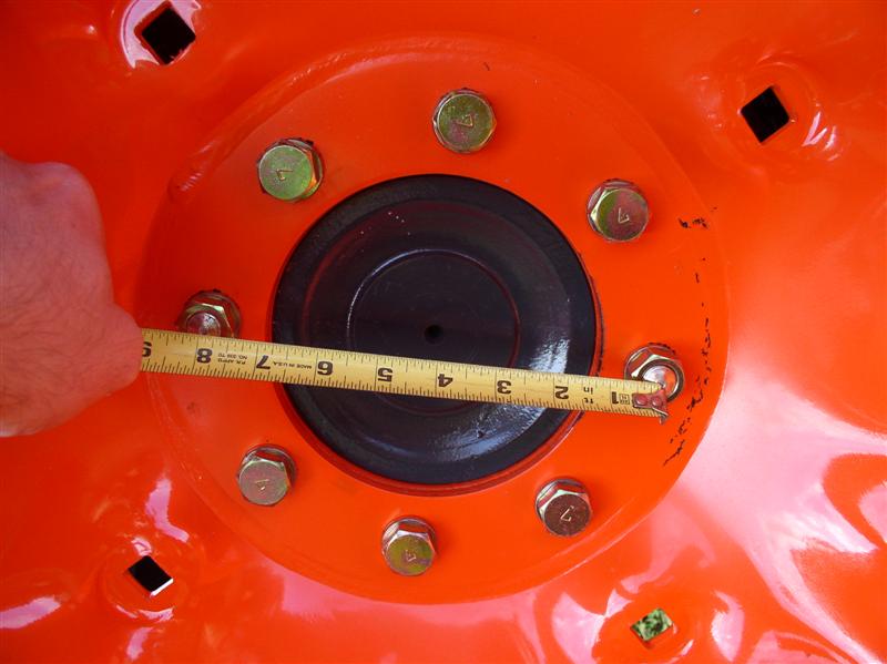

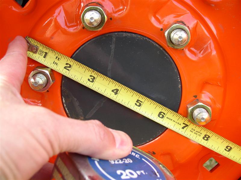

Welcome Joe. I was going to email you last time but had too much going on. I can send you the DXF file so it can go directly into the CNC. The problem I'm running into is cutting the center from the rim in a concentric manner. Not technologically but cost wise. Looked at CNC Laser, abrasive jet, etc. I think I'll end up with just a mill and rotary table.

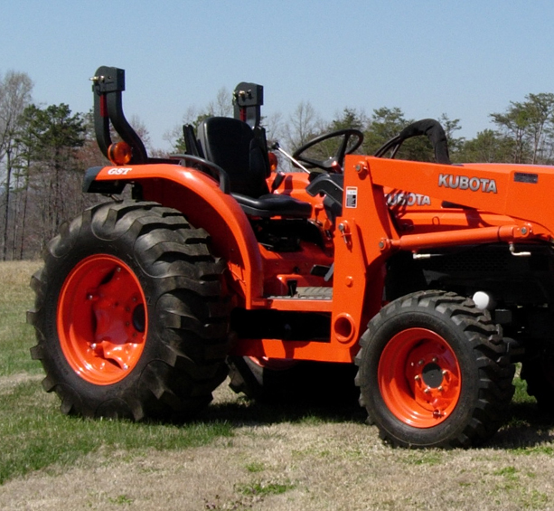

The rear adaptors are designed to allow a standard 8" BCD x 8 disc to fit. Standard R4 tire set from a kubota 5030 is 10-16.5 and 17.5L-24 gives the 5% lead req. Once you get the SAE 8x8 rear is adapted you could use R1's or R4's from a TC45 or 55. The new sets of tires and wheels are about $2300 total, 4 tires, 4 rims. They are made in the US by Titan so the cost is much lower than Japanese rims. The rears will bolt directly up but you will still need the front rim mod with the disc.
I'll try to finish the CAD print on the rear today.
I like the idea of multiple orders to the machine shop as it may save us some money.
Rear pattern looks like it will fit but the 2120 is 200mm BCD vs. 8in with a 151mm pilot hole.
Front will need the disc made
I bought these from a Kubota 5030 with R4's
