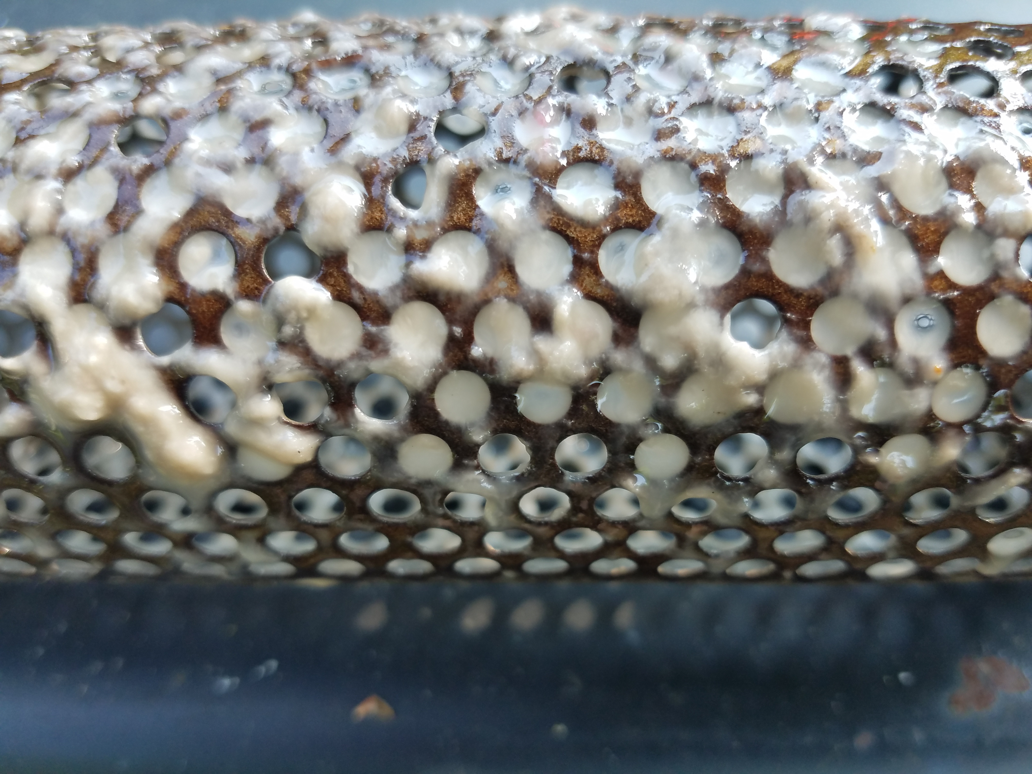

The problem I am encountering now is my hydraulic fluid is getting contaminated with... something. Not sure what.
I can run the tractor for 5-10 minutes, and the hydraulics will start to slowly stop functioning. Transmission works okay though, I can drive it around the farm all day. But, the loader and bucket will stop working completely within 10 minutes.
When I pull apart the assembly where the hydraulic oil screen is located, I get a thick white-like substance. Almost reminds me of white lithium grease. It completely clogs the oil screen to the point I get zero hydraulic pressure.
I cleaned out the whole assembly once and reassembled, and 10 minutes later it was clogged solid again.
I flushed the whole system out with diesel fuel, reassembled, and 10 minutes later it was clogged again.
I'm out of ideas. I have no idea what is or where it is coming from.

About the best I can get, this is after roughly 10 minutes of using the hydraulics.
Buddy of mine suggests I invest in a bunch of oil filters @ $3 each, remove the metal screen, and run the hydraulics though the oil filter alone, constantly swapping out filters until the contamination is gone. Would be cheaper than constantly draining and refilling the hydraulic oil. Thoughts?

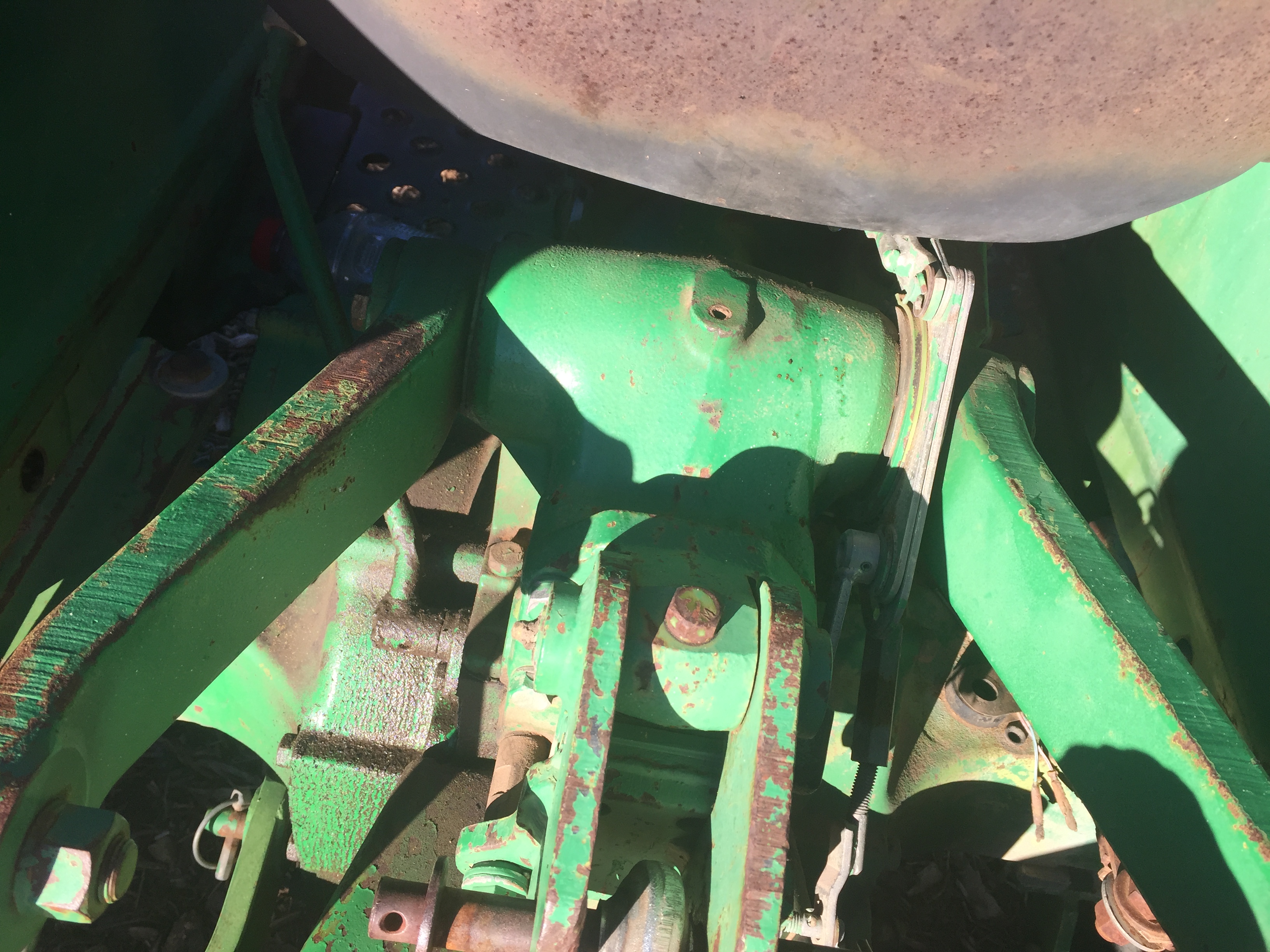

I had a similar but not as severe problem.
The cause was water coming in through the vent underneath behind the seat, it is suppose to be a candy cane but mine was broken off flush.
I replaced that, it is not a NPT taper but a British pipe thread, very similar but not the same. I got the replacement candy cane from Hoye, it was like $5 or so.
When I changed the fluid, there are three plugs, the big obvious one by the strainer/screen, one a little bit farther in front and one farther back, beside the swinging draw-bar.
All three of these had water when I pulled the plugs.
I didn't flush the oil, just drained all three and went from a slow weak hydraulic system that couldn't pick up the tractor to it doing push ups in no time flat.
Hope this helps.

I see no way antifreeze can get from engine cooling system to trans reservoir. My guess is it's water contamination with probably algae in it. Maybe you need to consider adding a biocide to hyd oil.
