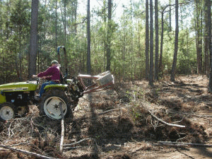

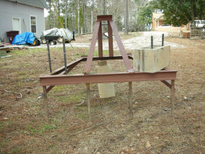

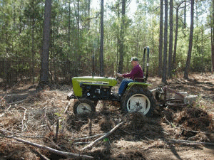

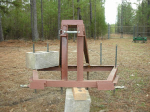

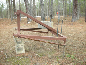

Hi All!
I have been doing a lot of reclaiming land from the forest recently. I have 14 acres and am building a new house on it.
Part of the process is cutting down unwanted trees and grubbing small trees. This has left a lot of big sticks and branches lying around. I got real tired of trying to manually pick these up and load them into a FEL.

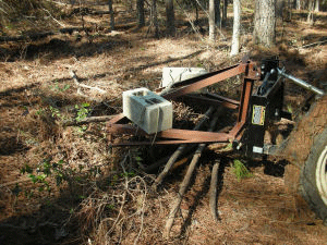

After looking at TBN's BIY section I decided a rake was in order. I was afraid that the spring finger tine type wouldn't put up with the branches wedged between trees etc. What I decided on was to use solid steel one inch rod as the dork tines and not use a lot of them to reduce dirt dragging.
This is where I started testing the design. If you look at the last picture, one of the center tines is bent. I hooked it on a big root. I then decided to beef up the tine support.
