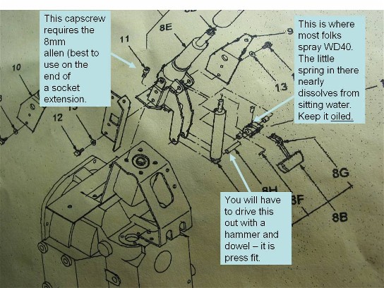

Here is a picture of the gas shock that controls your tilt steering on your New Holland TC series (at least for the TC25D/TC29D).

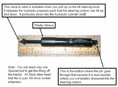

Here is another picture with some tips.
Cliff

Reviving a really only thread.....but what a !#$% to replace on a DX33. Snap ring on the bottom is a pain to get to and then you have to move the whole column assembly in order to get the pin out. Went together smooth, but boy was it a toughy to get apart. lol
