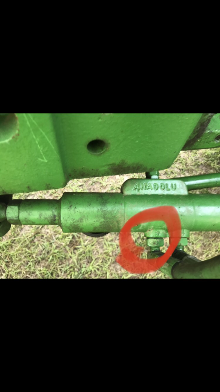

I have a 75 JD1120 with aftermarket powersteering.
The cylinder says “Anadolu”
I’m trying to save some time before I take this thing apart so I know what parts to buy and/or have an idea what I expect to find.
In the picture below I have circled a fitting that is leaking.
I’m unsure if it’s an elbow and jam nut with oring
OR
If it is a elbow threaded into an adapter with an oring.
I’m hoping to see an exploded parts diagram with oring sizes and part numbers for other pieces

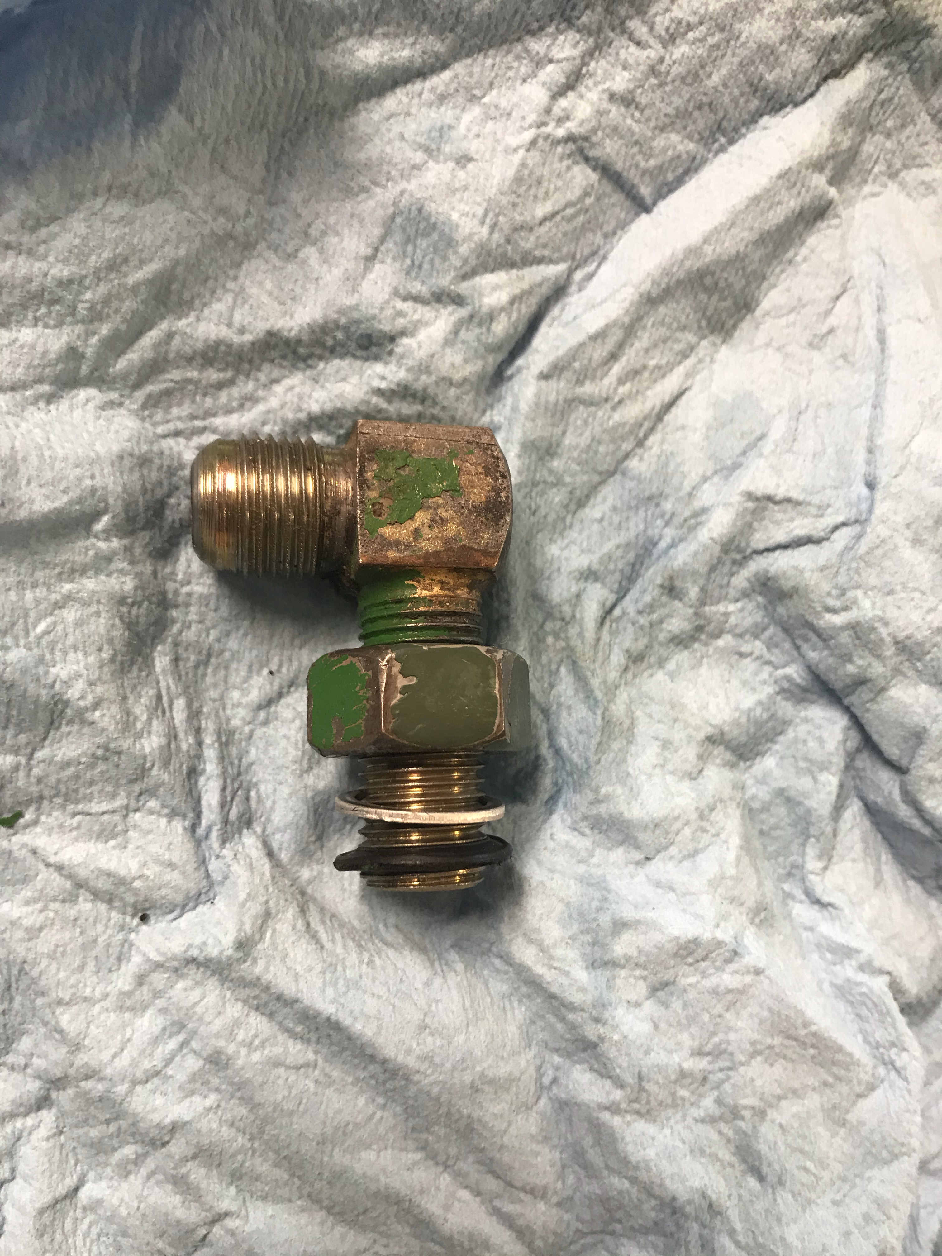

Ok I figured out a fix for it.
This is what the fitting looks like:
I went to Tractor Supply and bought these o rings:
Took about 20 minutes to do the whole job.
