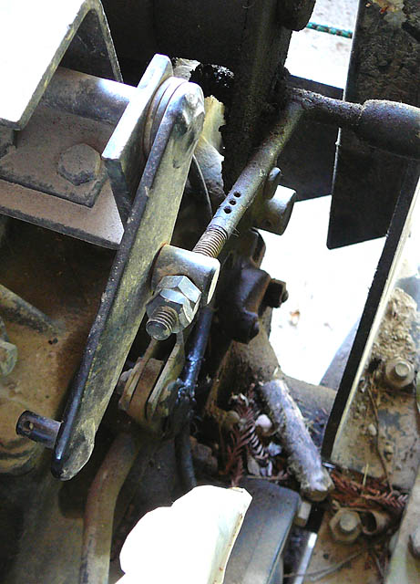

Guys, hat's this lever used for?
   / An unknown part #2
Is that connected up to the seat track mechanism?
   / An unknown part #3
Feedback rod for hydraulic system. Don't think you should attempt adjustment.
   / An unknown part #4
That's how the hydraulic lift system knows the position of the 3-pt arms.
It's related to the control lever over on the right, where you preset your intended height.
Diagram - from YM240 Operation Manual:
   / An unknown part #5
While you may not want to adj the link, it does look like the jam nuts are loose. What is the correct length so jam nuts can be tightened and result in correct length rod.

Hmmm...
Now I'm wondering if mine is set up correctly.
   / An unknown part #7
I wanna know this also.

If anyone understands this Position Control rod and has good setup instructions, I'd appreciate a little enlightenment.
   / An unknown part #9
Aha!
Followed my own advice, RTFM, and look what I found.
In this diagram, the two jam nuts on the feedback rod are near the end of the threads.
It looks like mine (photo, above) is set up correctly to match its Operating Manual.
   / An unknown part #10
I don't have my service manual handy, but is there any info on how to adjust it if it has been assembled incorrectly, as gcp's appears to have been? I'm sure they are all different, like mixture screws on a carburettor.
