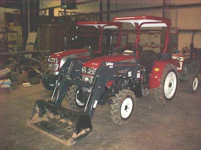

Here is a picture of a JT 2004 with FEL ... the same as JT 2504 except the HP is 26 HP on JT 2004 and 32 HP on the JT 2504
The picture shows both but JT 2504 doesn't have the FEL installed as of yet.
The JT 2004 is the one we "played" with outside and got it muddy.
