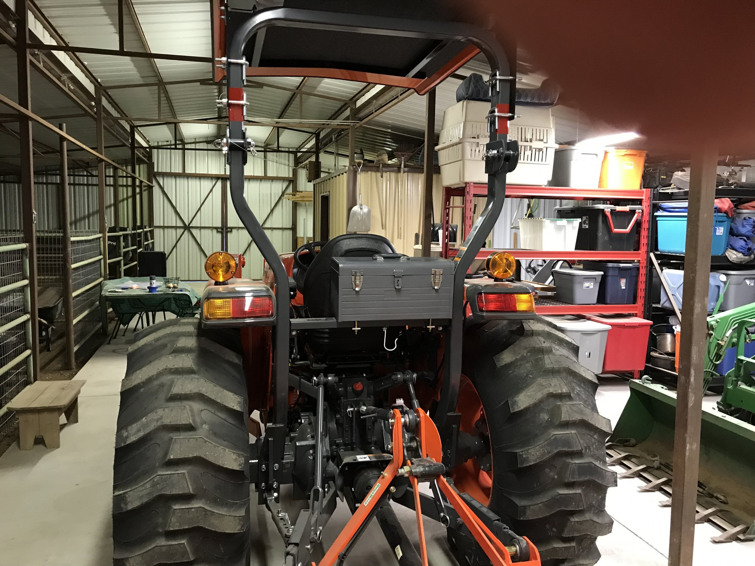

I just removed the factory plastic box and installed a useable toolbox in the same place.

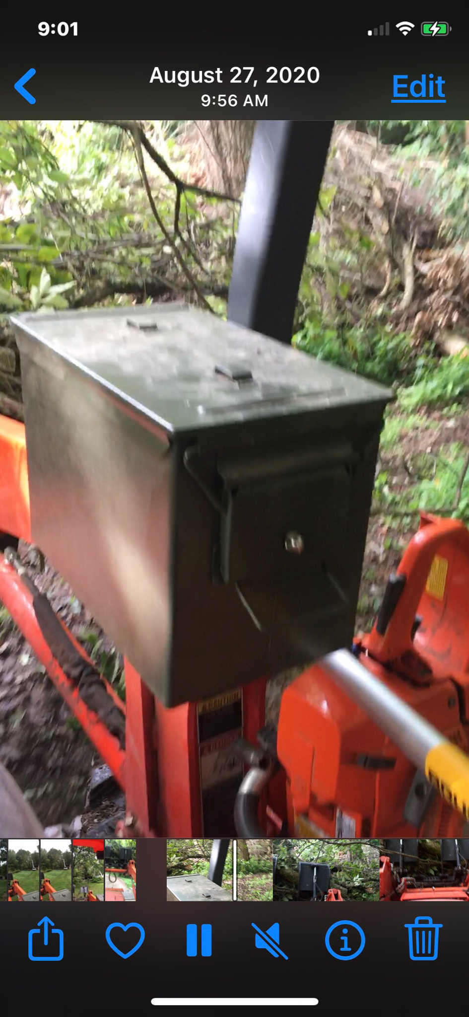

Big 50cal ammo box. Attached with 2” square U-bolts to the front ROPS. Added 3.5 x 5.5” x 0.25” plates inside and outside to strengthen attachment to the box sheetmetal side. Also gives clearance for lid flanges. Large size accommodates tool, hammer, wrenches better. Added lock stud. Bought from Ammocan man.
Have a regular 50cal on smaller tractor as a first attempt. Used two existing ROPS bolts. Found the big 50cal is much better for tools afterwards.
The lids are designed to slide off the hinges. Open lid on running tractor while hooking up equipment can vibrate off. To prevent this added a small bolt at hinge. A sheetmetal screw would probably work too.
