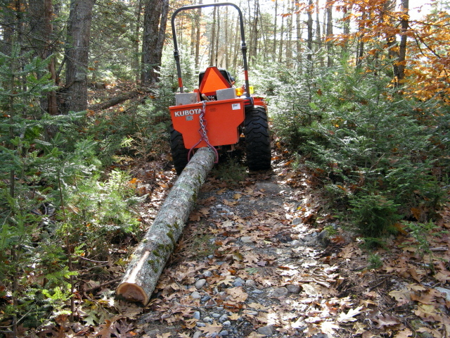

Here's my homemade setup for getting some firewood off my lot. Length of chain bolted to the rear ballast carrier with skidding tongs that have a grab hook for the chain. Pick up the carrier and the log comes up. Hey, it's not professional but it works. The log on there is probably only a few hundred pounds but I think it could do 12 to 16 foot lengths without a problem (except turning corners). Good for my little operation.

Looks good. I like the capacity of the larger front loader. You can probably pick up bigger logs if your ballast box is empty. That might help with turning as well.

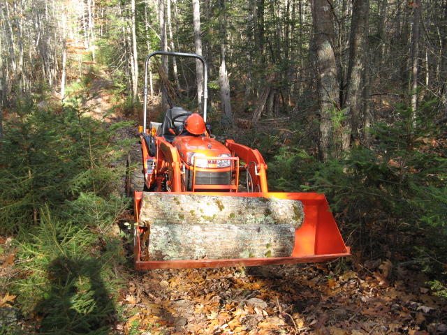

Thanks. You could be right. I've got cement blocks and sand in there so it's kind of a pain to unload then reload if I'm just using the front loader. For now I think it will pick up medium sized logs ok.
That's the larger bucket and QA from the B3200. I put the smaller 50 inch bucket on for dirt/gravel/rock work. Next big purchase is the forks. Then maybe the hoe if the economy improves.

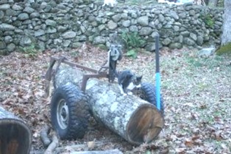

Back 20+ years ago I made a tow behind device that can suspend the log off the ground for transport. Today they are called logging arches. With mine I can lift and carry a 24" diameter 16' log which can be pulled by an ATV or better a compact tractor, my 30 hp. Kubota works well.
Turning is a little easier as the pivot point for the log is about 9 feet behind the tractor, the rear end of the log however does swing a little wider arc.

Nice arch you built there. Had one similar that started out as a deer cart to "walk" deer out of the woods. Turned it into a logging arch very similar to yours.
I see you have a LogRite cant hook there. They are such an improvement over the wood handled ones of the past. (Northern Tool has a Chinese knockout copy of the tool, but the handles bend easily). I see LogRite also has several different size arches too.

That is the good way to get started. Usually I drop the ballast box and use the hook on the quick hitch (IMatch) to lift and tow logs out of the woods. Something in the bucket helps contain the front end to the ground. :)
