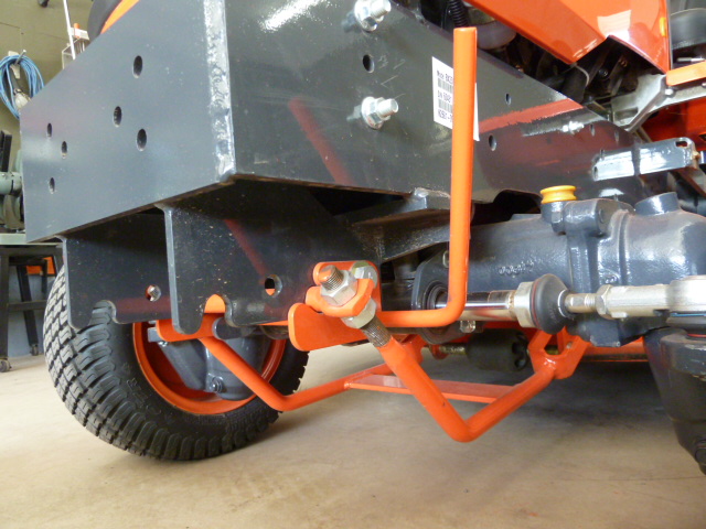

Finally have a dry day and im trying to hook up my mower... But it appears i might be missing parts. Well a single part actually.
I have the rck54p-23bx deck.
I have the front "L-shaped" link, that goes from the deck to the frame of the tractor, but it appears that im missing the lever/bracket that locks this link in place. I assume im supposed to have on on a BX25? Ive seen some deck hook up videos online, but none featured the BX25... just other models in the BX series.
I dont have a manual for the deck and the factory tractor manual is pretty vague, and recommends seeing the deck specific manual. No help there:D
This is a brand new deck, never been installed so i have to level as well... not 100% sure on that either:laughing:
Its a holiday here, so my dealer is closed.. Id like to mow today while i have a break in the weather, so any info would help...
Please see attached picture. The "lever/bracket" in question is inside the yellow circle.

I am thinking the the pin to lock the ladder shaped bracket is part of the bracket itself.It should be spring loaded if I recall correctly.What part of Nova Scotia are you from?I live near Windsor.

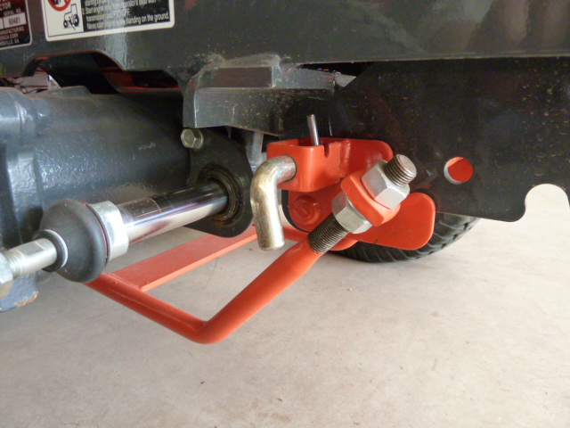

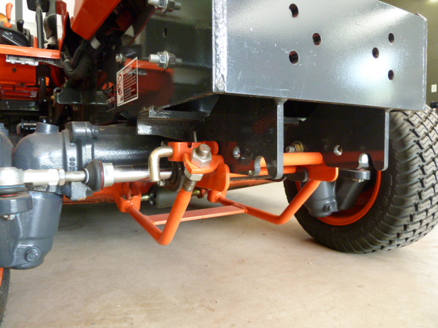

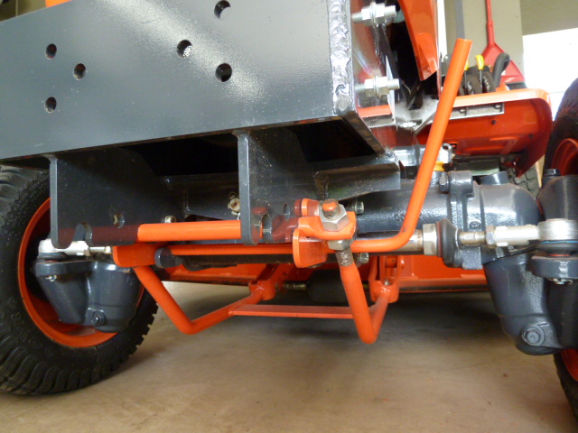

I just took a few pictures of my BX2360 mower deck.It should be the same as yours.Hope this helps.

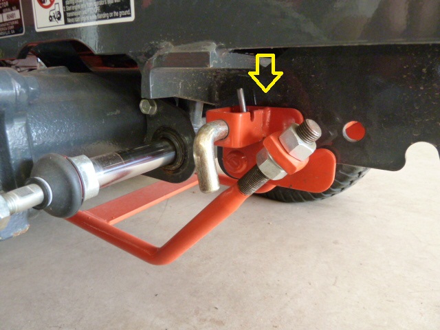

Looks like im missing a piece. I took the liberty of modifying your pic. The part that the arrow is pointing to is the part im missing.
The lawns going to be some high when i finally get it mowed as my dealer is 100mi away:eek:

Although my deck was mounted when the dealer delivered it. I checked it out according to the "Rotary Mower" (code #K5381-7111-2) manual and must have spent about three hours adjusting and leveling it according to the manual. You better get it along with the missing part, especially since the dealer should have provided it to begin with. Best wishes up yonder.

We have that pin, so I guess it's missing...

Picked up the bracket yesterday, however he didnt have my manual:mad: Im going to post a thread looking for a source of the manual online. Havent had any luck finding it for download on any of the regular sites
